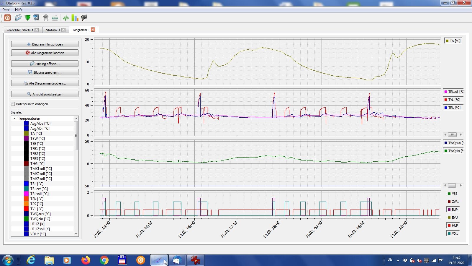

Daniel-Sp20 Mar 2020 08:47Hello,
chewbacca123 provided me with the DTA file, and I have reviewed it carefully.
If the data recorded in the DTA is accurate, which I assume it is, the heat pump is basically operating correctly. The compressor has been off since about 7:00 AM. The temperature trends for domestic hot water, supply, return, and heating gas appear normal and plausible. The pumps also seem to be running properly (at least they are being correctly controlled by the Luxtronic). The temperature curves also indicate that the ZIP, HUP, and ZUP are being correctly controlled and functioning. I cannot verify what the display shows, especially since the displayed temperature does not match any temperature readable from the DTA data.
Let’s see what the plumber says.
The plumber was here and could not detect any irregularities – this is confirmed by the DTA.
