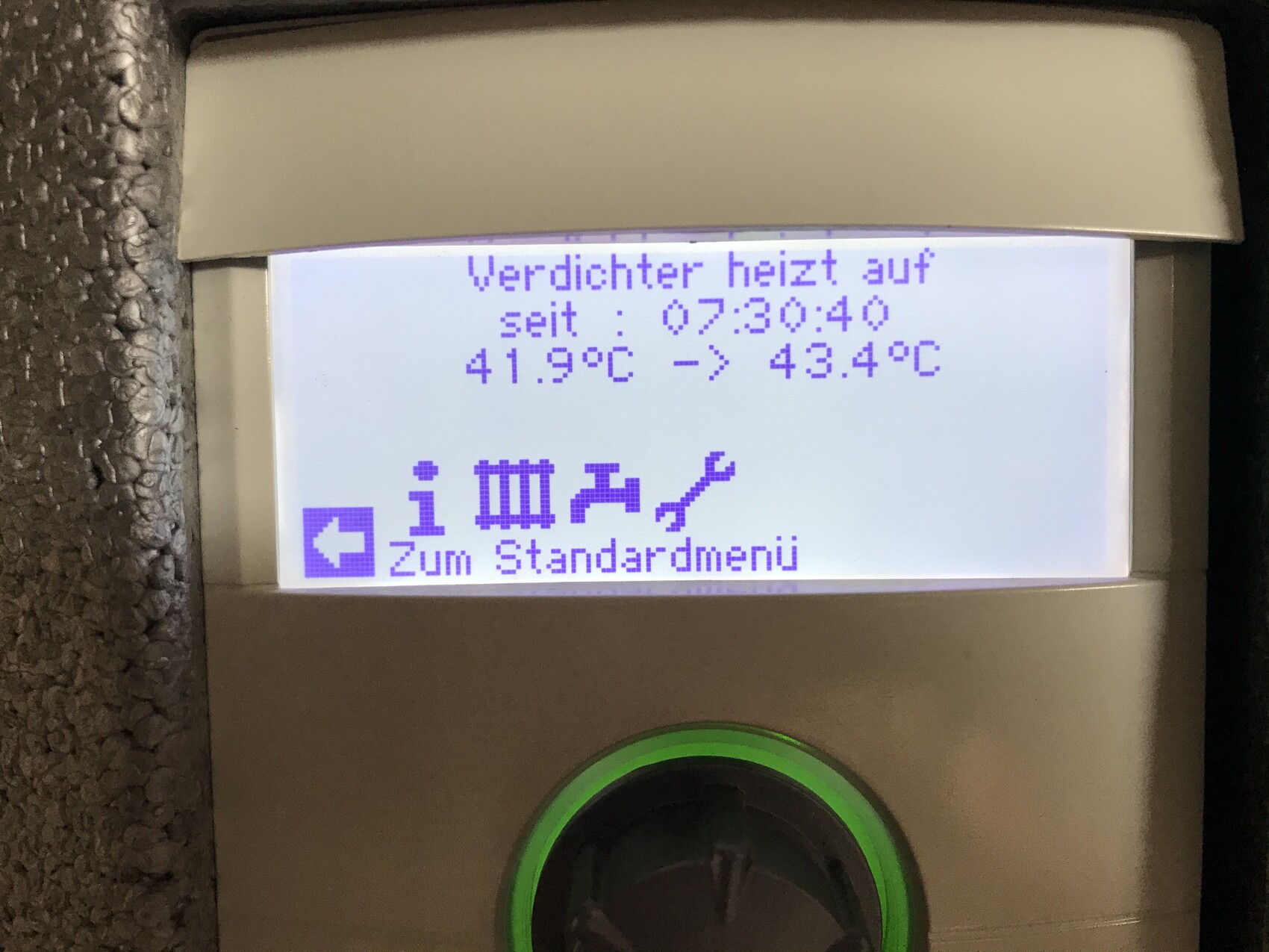

Then you probably installed significantly more piping; we stuck to about 10cm (5 inches). That likely results in a higher flow temperature, otherwise the house gets too cold.The alternative would be to increase the flow rate. Ten centimeters (5 inches) is not too bad when you consider that some heating contractors still install 15 or even 20cm (6 or 8 inches).
If necessary, you could also make some adjustments by reducing the hysteresis. This leads to less fluctuation in the flow temperature but causes the heat pump to cycle more frequently. So, more cycles but a more stable flow temperature. In return, you would then lower the end point of the heating curve.
guckuck2 schrieb:
The alternative would be to increase the flow rate. 10cm (4 inches) isn’t too bad considering some heating contractors still install 15cm (6 inches) or even 20cm (8 inches).
Potentially, you could also improve things by reducing the hysteresis. That would result in less fluctuation in the supply temperature, but the heat pump would run more often. So, a few more cycles, but a more stable supply temperature. At the same time, you would lower the endpoint of the heating curve. Yes, there’s probably still room for improvement, but I’m not in the mood right now. Everything runs smoothly; maybe I’ll tackle it again next winter.
The pipes were 18mm (3/4 inch), I checked...
boxandroof24 Jan 2020 16:03Bookstar schrieb:
Then you probably installed significantly more piping; we stuck to about 10cm (4 inches). That likely results in a higher flow temperature, otherwise the house gets too cold.The type of floor covering also has a considerable impact.
