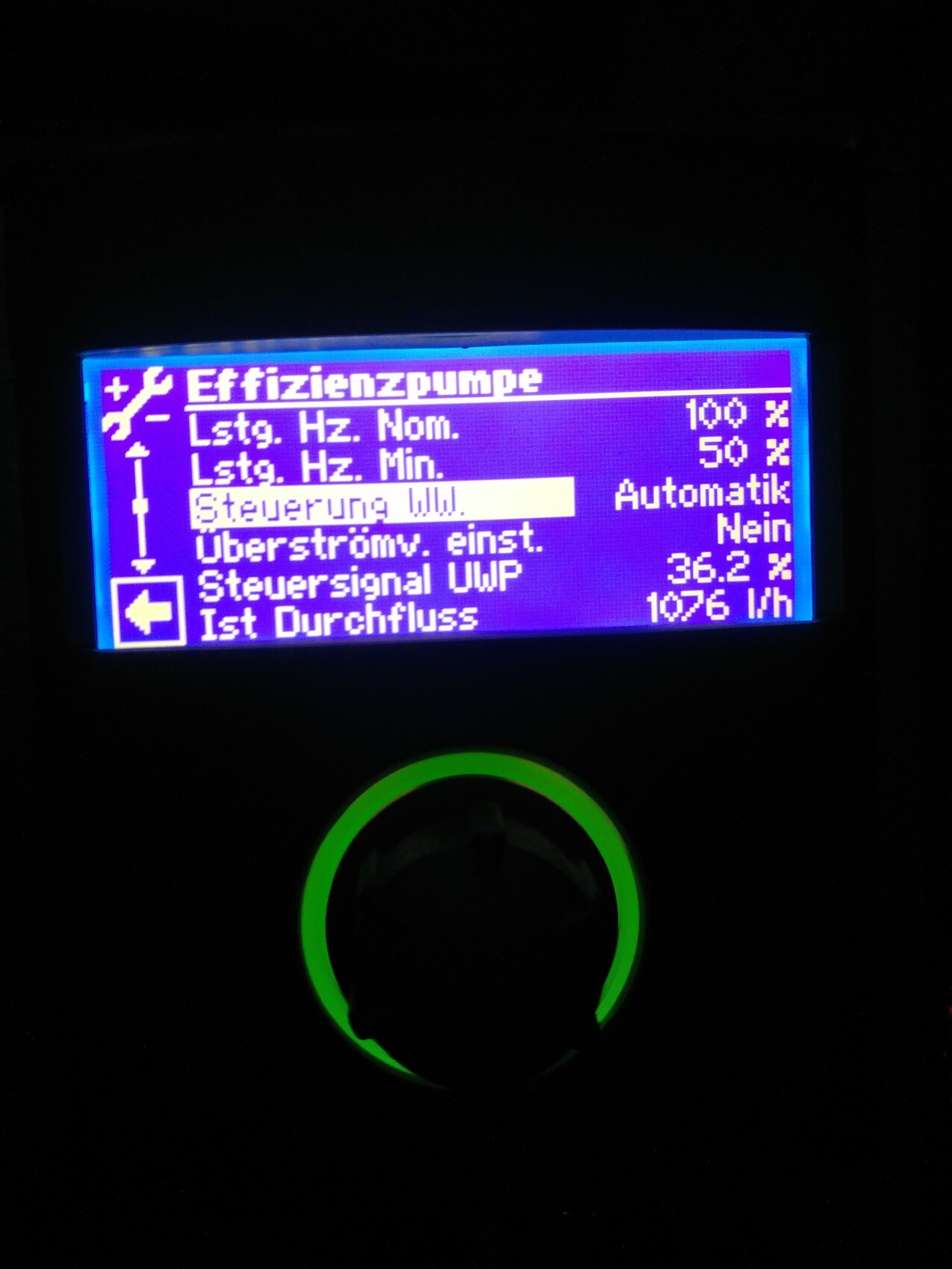

If applicable, close the existing bypass valve, fully open the ERR, or remove the actuators, and turn up the Taco setters. If there is still insufficient flow in the system, increase the circulation pump speed. Everything has already been done except increasing the circulation pump speed. How can I turn it up?
Daniel-Sp30 Dec 2019 12:50ivenh0 schrieb:
Everything is done except the circulation pump. How can I increase its speed? What kind of system do you have? Maybe start a separate thread...

[ATTACH alt="29-30-December.jpg"]41317[/ATTACH] I will definitely halve the hallway again now; the living area is already fully open.
Hopefully, when I get the documentation next year, I will know how many meters of pipe are installed where. They say the bathroom has the most, but it’s strange that not enough heat is reaching it. :-/
