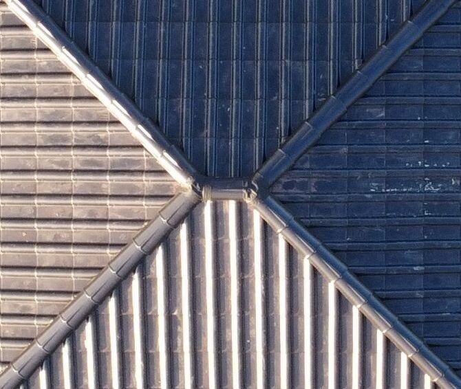

3. On the hip (ridge), no hip caps were installed, but it was sealed only with Wakaflex. Could this cause a leaky roof, or does such sealing hold without problems? Photo attached:
Visually, it’s hardly noticeable since the house is tall enough, and the appearance is not important to me – my concern is purely functional. Is a hip cap mandatory?
