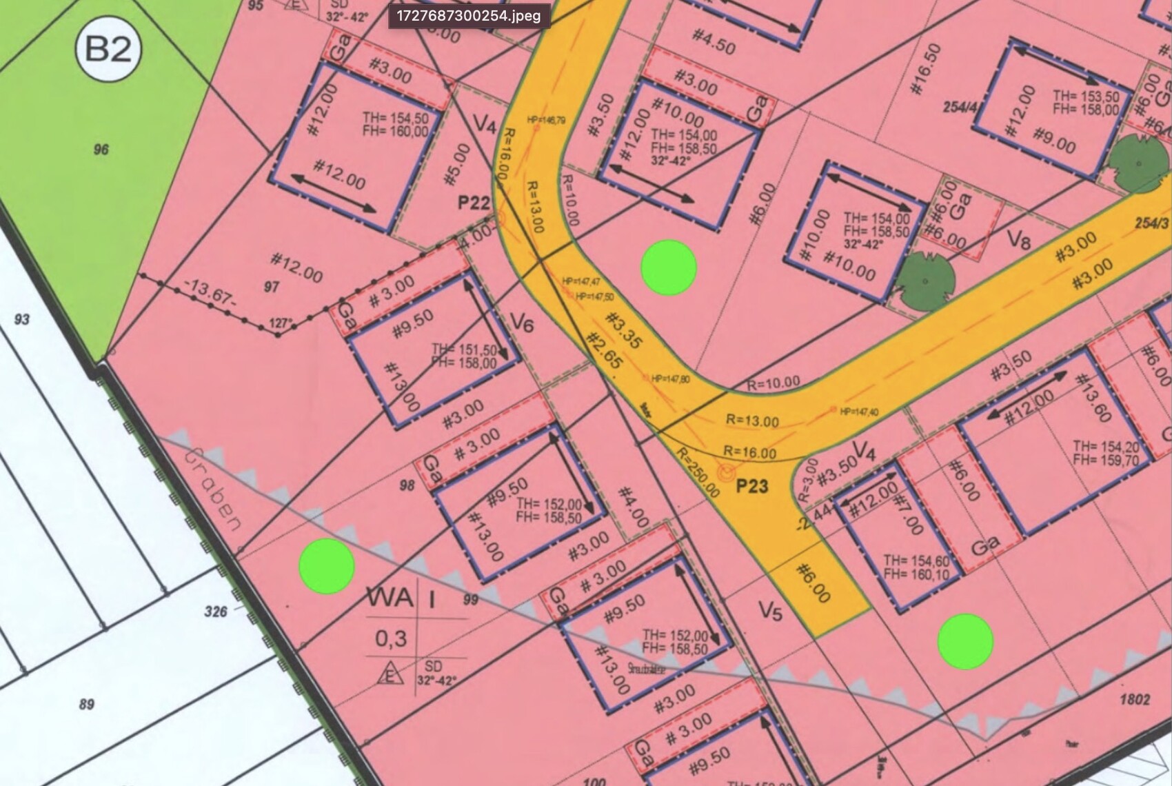

I’ll step back a bit: We have already briefly discussed this plot in my earlier thread (relevant details and plan on page 2 of “Plot suitable for narrow house for 5 people?”). Thanks again for your input there!
Now it’s getting more specific about the other “west plot.” However, we are still in the allocation process for all the very different plots described in the previous thread.
Actually, a new thread wasn’t really necessary – feel free to close it. I am currently looking specifically for examples of model houses with the mentioned gable rotation. I assumed that standard plans with the ridge running along the length might not suit a gable perpendicular to that, but I’m happy to be proven wrong. I’m also looking at ready-made houses to check whether this (supposedly) more affordable approach alongside architect planning could be an option for us.

Thanks – for clarification:
Unfortunately, the short-side eave alignment seems to be a stylistic preference in our area. Here again is the development plan from the other thread (“„Is the plot suitable for a narrow house for 5 people?“, p.2). As mentioned, if this feels like a duplicate post, I’m happy to close it.
This concerns the western / left plot marked with a green dot, and the very similar plot (without a dot) directly south of it.
TH: 152, FH 158.5, floor area ratio 0.3
