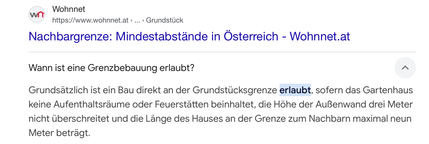

leinoel schrieb:
I read through the building regulations again; in our case, only a maximum footprint of 100m2 (1,076 sq ft) and a building height of 3m (10 ft) apply for the outbuilding—
I would double-check that. Have you read the general Lower Austria Building Code, the garage regulations, fire protection rules, neighbor law, or whatever else applies? As mentioned before, sensible laws tend to be similar across the regions.
I don’t really care where you put your sauna, but if you are planning your house, you should be able to apply the relevant laws.
