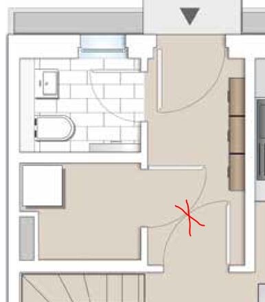

We are buyers of a semi-detached house (turnkey from the developer). A few days ago, we visited the house for the first time and noticed that two doors leading to the hallway (from the living area and the storage room) touch each other when opened at the same time. To help illustrate this, I have attached a screenshot from the property brochure.
We have reported this issue to the developer, but we have no idea whether this is acceptable or common practice. Is there a relevant standard or building regulation? After all, this also concerns an emergency escape route. Unfortunately, I couldn’t find any information about this online.

You cannot use the argument of an "escape route" here, as I must be able to evacuate "without obstruction." Besides, it does not comply with recognized building standards and is considered a defect that must be corrected free of charge, for example by making the door to the utility room smaller.

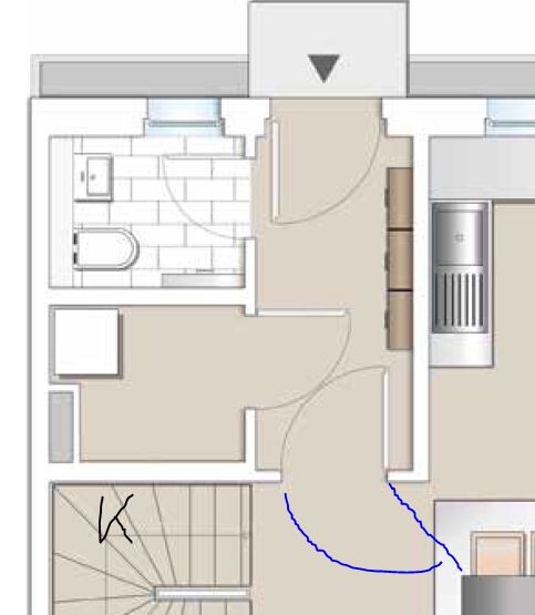

However, due to the stroller and the necessary space for a closet, we don’t want the door to open inward into the storage room.
The only option we can still think of:
Is it allowed for the door to open into the living area? Or is that prohibited for safety reasons (too close to the stairs leading to the basement and/or opening into the room)?
To be honest, we don’t really like this solution either, because the door would open so far that it would hit our dining table... =/
Ideally, it would be a) to move the door frame, or b) to replace the door with a sliding door (but which one and how?).
