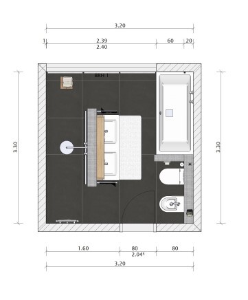

we can’t decide between two bathroom layouts at the moment.
On this sleeping floor, we have only this one bathroom for 2 adults and 2 small children. Yes, a second toilet would have been nice, and a bigger bathroom would always be better, but this is the space we have to work with.
I like that in the layout with the T-wall the toilet is somewhat separated, but I’m worried that this wall might make the room feel even smaller than it already is.
In the version with the large shower, I simply like the shower itself.
Please share your initial gut feeling.
And if anyone has a great new idea right away – please bring it on.
allstar833 Sep 2020 13:05Maybe consider having the door swing outward? It might also improve the sense of space.
In Bathroom 2, I find the space poorly allocated. The shower area takes up half the room, and the rest has to fit into the remaining half. In my opinion, such a large shower with two entrances doesn’t suit a bathroom where space efficiency is important.
I like the separate toilet in Bathroom 1, especially if four people are going to use the bathroom. I might consider swapping the sink and bathtub, so you don’t walk straight into the bathtub when entering.
Alessandro7 Sep 2020 13:20Bathroom 2 is way too small. Also, you shower in front of the window, which isn’t to everyone’s taste.
