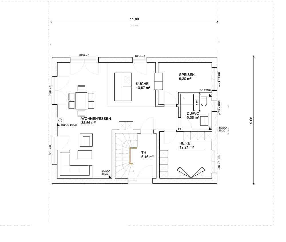

That partly depends on the building envelope – with a semi-detached house, it may be difficult to include a large storage room on the ground floor – as well as other textual requirements. Attached you’ll find one possible solution among many, but one with a building permit.
