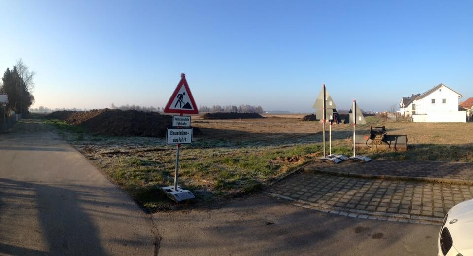

It’s been a while, and fortunately, I’ve learned a lot since then, also thanks to many justified skeptical opinions.
Since we didn’t get the plot last year, our application for a new 555 m² (approximately 6,000 sq ft) plot under the local resident allocation model is currently with our local market. The decision on whether we will be allocated one this time will be made in September, but things look promising!
As land prices here have increased by more than €50 per m² (approximately $5 per sq ft) since last year, our budget has naturally been expanded. Our current target and maximum spending limit is €400,000 (including equity), preferably less, but that’s where we stand at the moment.
A basement is not feasible from a cost perspective, so we have decided on a single-family house with around 140–160 m² (approximately 1,500–1,700 sq ft) and a double garage with an adjoining annex at the back for garden furniture and such. Of course, it’s possible the double garage will become a single garage with a carport, but that will become clearer during detailed planning as we look for some savings to invest money better elsewhere.
Currently, we are considering between Danwood (a prefabricated house KfW70 standard) — with which two of our friends have had good experiences — and an Austrian Passive House with even greater energy efficiency due to new and special insulation.
Here is roughly my cost breakdown, now much more realistic than it was a year ago. Maybe some of you might find something that stands out.

Bauexperte schrieb:
electrified garageWhat exactly does that mean? It doesn’t seem to refer to the door since it is mentioned separately. Does it simply mean that the garage has a light and an electrical outlet?
Bauexperte26 Nov 2015 14:55sirhc schrieb:
What exactly does that mean? It seems unrelated to the gate since it is mentioned separately. Does it simply mean having a lamp and an electrical outlet in the garage? More or less, yes.
Junction box, switch/socket combination as well as lighting and a radio code keypad. The latter allows you to control the gate system using a numeric code of up to five digits.
