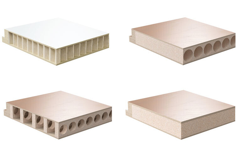

nordanney1 Apr 2021 11:05Here is an overview of door cores: honeycomb core, tubular chipboard strips, tubular chipboard, solid chipboard (listed in order of quality and price).
The more substantial and solid the interior, the stronger the door. This also significantly affects sound insulation. I would not recommend using tubular chipboard.
