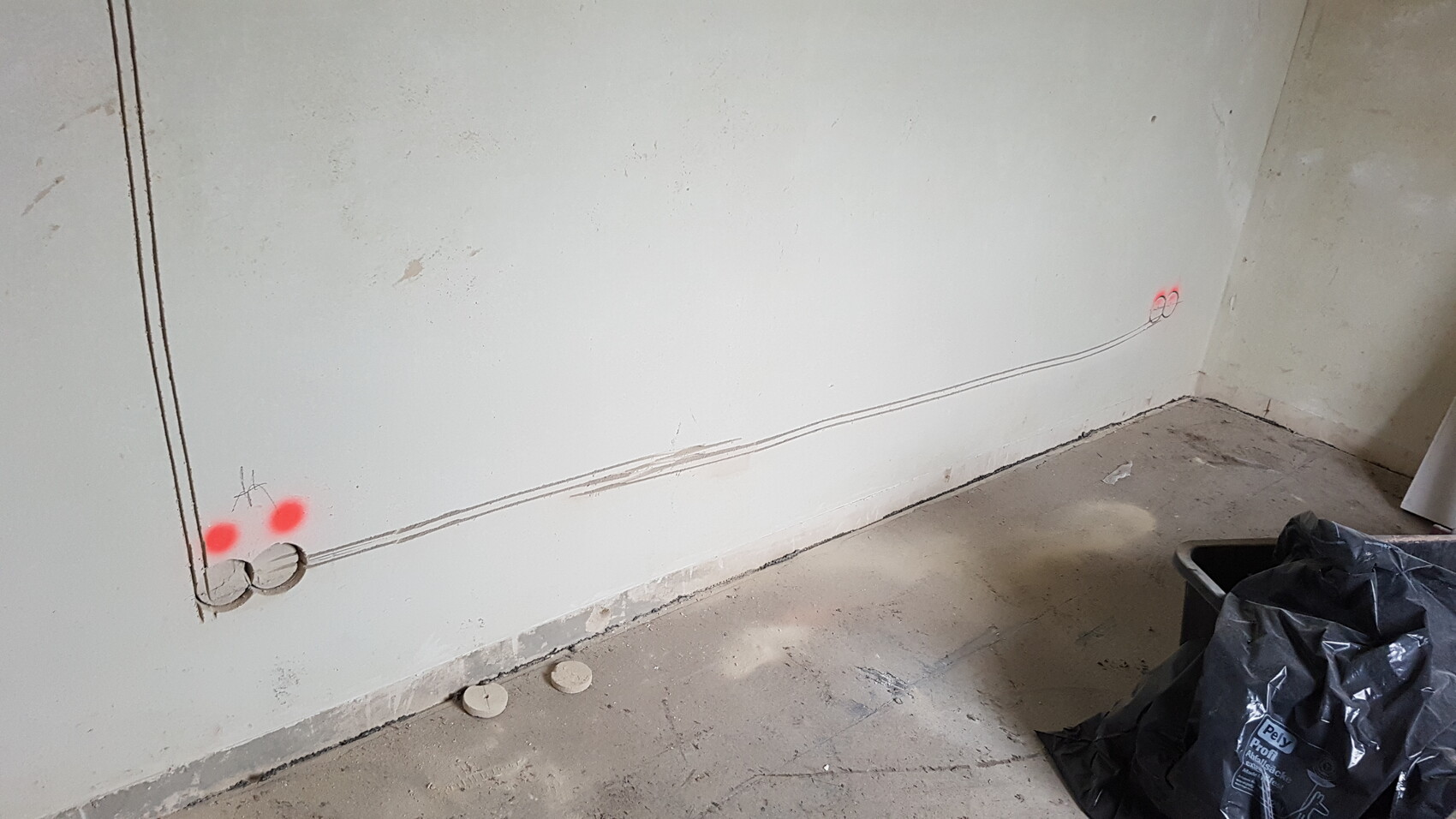

- Every single socket outlet still needs to be discussed with us again, even though we marked everything with marker paint

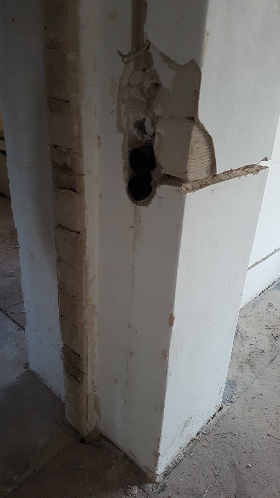

- He doesn’t mark the chases, but just cuts straight into the wall (and it looks exactly like that!)
- Cable conduits apparently cannot be installed inside the wall due to the structural stability (11.5cm (4.5 inches) bricks), which was previously agreed differently

Today, I noticed that the light switches in the rooms are not all at the same height and the sockets (those black inner trims) have all been installed crooked.
Sockets were originally agreed to be below the light switches but are now located near the floor.
Also, the preparation for the ceiling lamp is not centered in the room.
And it goes on...
Is this really all still within the tolerance range??
