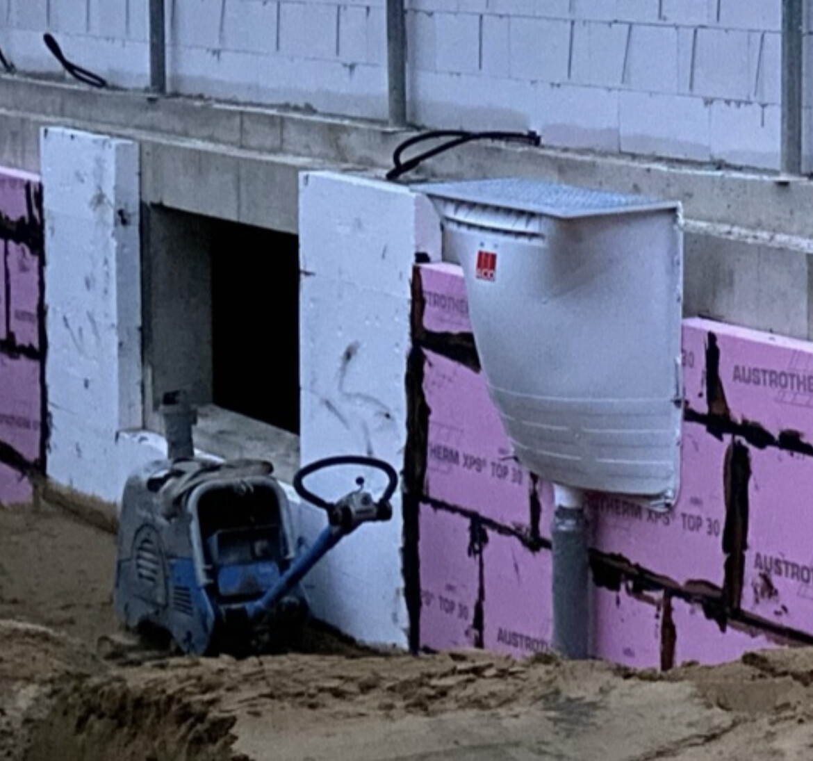

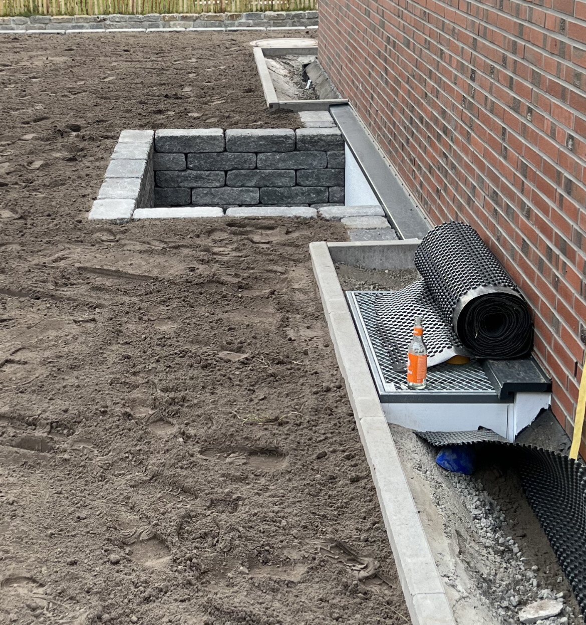

My main question is about the roots and what they might do to the exterior basement insulation. The basement is built with a waterproof concrete wall, so roots shouldn’t penetrate it, and the house would never leak because of roots.
Should I be worried about the insulation when planting a fig tree at this distance, or is 1 meter (3 feet) sufficient?

Attached again are pictures of the shell construction and the site after landscaping. The distance from the light well is also 1 meter (3 feet), just like the distance from the exterior wall.

Do I need to worry about insulation for a fig tree here, or is 1m (3 feet) enough?You can try searching for "roots + fig tree." You will find that fig trees have a) shallow roots to stabilize the trunk and b) a taproot growing downwards. In summary: No worries.
You could at most add a root barrier as a precaution against superficial roots in between. The previous owner of our plot insulated the shaft of their cistern with EPS and XPS. The EPS was intact, but the XPS was partially penetrated by roots. I wouldn’t be too concerned about the house itself.
