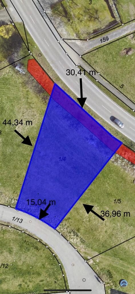

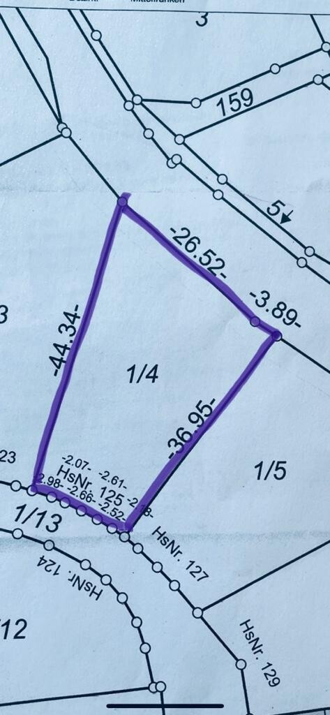

Dear forum members,
We have purchased a trapezoidal plot of land (874 sqm (9400 sq ft)) and are now faced with the task of efficiently placing a house (approx. 10 x 12 m (33 x 39 ft)) and a double garage on the property.
The north side borders a state road (top). The driveway to the property is from the south side (bottom).
We are still quite unsure and would appreciate your ideas and advice.
Thank you very much in advance for your effort!
Andrea
Lageplan: Blaues Polygon-Grundstück mit rotem Randstreifen; umliegende Straßen und Maße.
Geometrisches Liniennetz-Diagramm mit violettem Polygon, Knotenpunkten und Beschriftungen.
driver55
1 Nov 2021 13:14
FoxyBrown schrieb:
State road
That means we are in Saxony or Bavaria.
Is the red strip intended as noise insulation?
Place the house and terrace as far south as possible.
But first, the building plan is needed…
FoxyBrown schrieb:
Task: to sensibly position a house (about 10 x 12m (33 x 39 ft)) and a double garage on the plot
Sounds like "the house is already planned." 🙄
kbt09
1 Nov 2021 13:18
Is the plot lower than the street level? It looks like the ground slopes upward about 3m (10 feet) to the north.
Building boundaries?
Floor area ratio?

FoxyBrown
1 Nov 2021 13:28
driver55 schrieb:
So, we are in Saxony or Bavaria.
Is the red strip for noise protection?
House and terrace positioned as far south as possible.
But first, the zoning plan is needed…
Sounds like “the house is already planned.” 🙄
Thank you for your reply.
Yes, we are in Bavaria. The red strip is an existing hedge that serves as noise protection.
The zoning plan / building permit is available and specifies a pitched roof with a slope of 42-44 degrees and a knee wall height of 50 cm (20 inches).
The floor plan is still in the planning stage but not finalized yet, as it also depends on the placement of the front door. (approx. 180 m² (1,938 sq ft) of living space).
11ant1 Nov 2021 13:31
FoxyBrown schrieb:
The development plan is in place and specifies a gable roof with a pitch of 42-44 degrees and a knee wall height of 50 cm (20 inches).
Oh, only the pitch and knee wall height, but no ridge direction / building axis?
