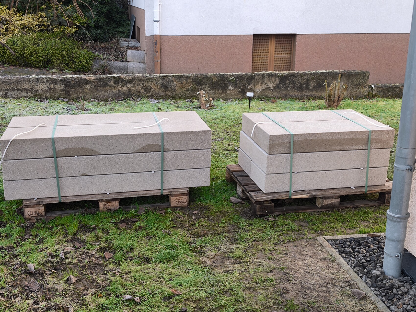

We want to transport and install 6 steps measuring 100 cm (40 inches) weighing 120 kg (265 lbs) each, and 6 steps measuring 150 cm (59 inches) weighing 190 kg (419 lbs) each, from the property boundary to the terrace (approximately 15 meters (49 feet) distance).
A landscaper will do this, whose equipment is rather average. However, that doesn’t matter because he has delivered good performance and quality.
The terrain is fairly level with some slight slopes in between.
My two concerns/questions:
1. Transporting the steps – what would you recommend?
2. The procedure for installation – individual work steps, materials, tools.
Are there any instructional videos available?
Thank you very much for your support!

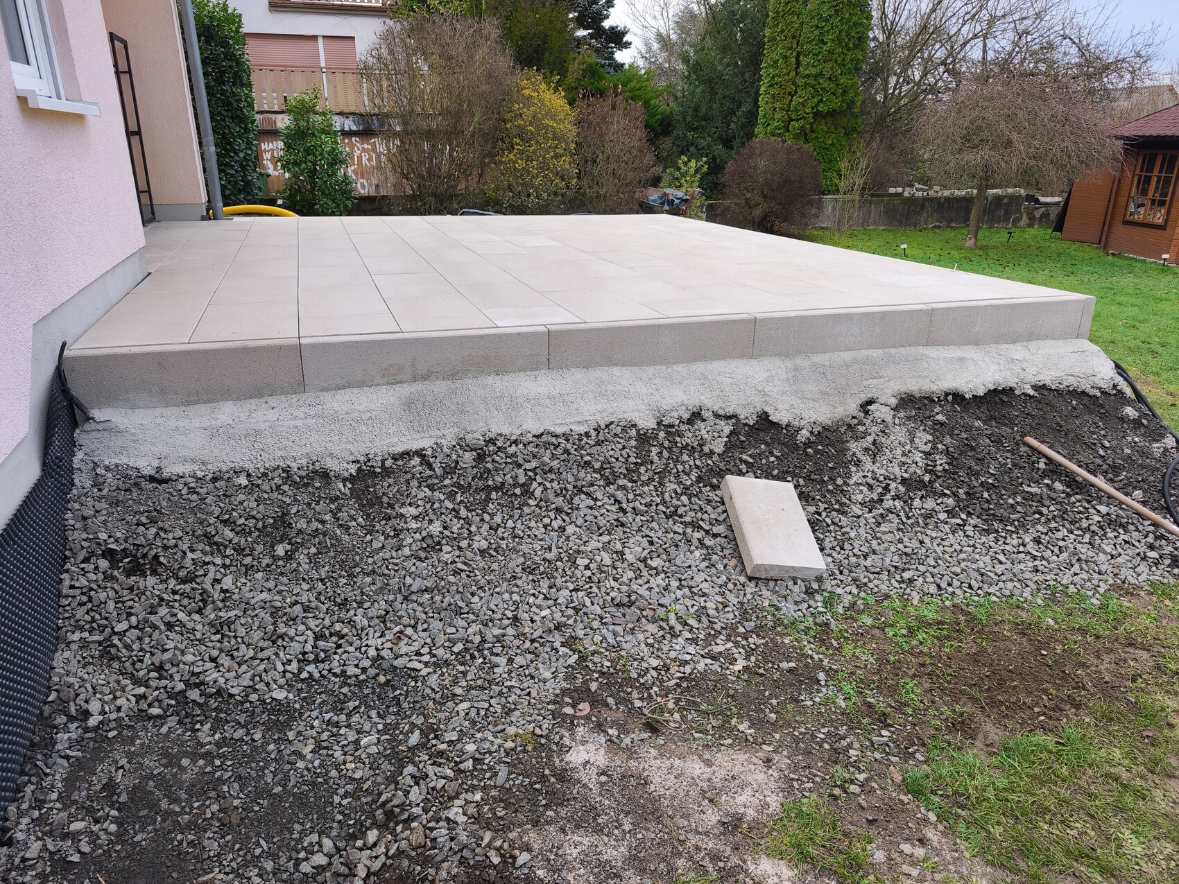

I only see a thin layer of concrete there. I was told there should be 15-25 cm (6-10 inches) of concrete underneath.
I find that hard to evaluate.

nordanney5 Dec 2025 18:52uweuweuwe schrieb:
I only see a thin layer of concrete there. I was told there should be 15-25 cm (6-10 inches) of concrete underneath. If the bottom step is positioned correctly, not much concrete is actually needed. However, it is important that a solid support is poured on the sides (like with curbstones).
