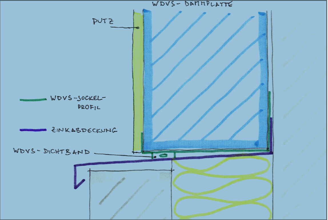

It’s about the transition from a brick facade to an external thermal insulation composite system (ETICS) with plaster. How should it be correctly executed? I have two sketches; which option is preferable regarding thermal bridging caused by the metal sheet, or is it negligible? Does anyone have experience with this?

This is how we solved it (drawing by the architect):
Sketch of a wall construction with external thermal insulation composite system, plaster, sealing tape, and zinc flashing
alexm86
9 Nov 2015 20:26
Thanks for the reply. So, the zinc covering is not a thermal bridge?
And one more question, is there no wooden board under the covering, or was it just not shown in the drawing?

alexm86 schrieb:
Thanks for the reply. So, is the zinc covering safe in terms of thermal bridging?
And one more question: is there no wooden plank under the covering, or was it just not shown in the drawing?
No idea 😉 – but I believe there is wood under the covering. The thermal bridge is probably negligible.
This way you can be sure that no water gets into the cavity insulation when it rains.
