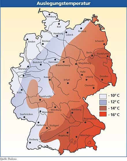

No, you don’t need it. In both of our bathrooms (including the small children's bathroom), the temperature is around 23–24°C (73–75°F), and that’s enough for us. The towels also dry very quickly since the exhaust air keeps the bathroom from getting humid. It depends... A heating system is always designed based on an outdoor temperature, and a bathroom as the warmest room should, as far as I recall, be able to reach at least 23°C (73°F).
And if you live in Nuremberg or even better: on the Swabian Alb at about 700 meters (2,300 feet), then on some days with -14°C (7°F) outside it might be tight, because the heating engineer will size your system for exactly that:
If they can’t do it because you don’t want an additional radiator, then they MUST raise concerns with you. Otherwise, if you later complain in winter that the bathroom is too cold, they have the upper hand and can be held liable!
On the other hand, if you don’t mind this or are willing to accept it (or maybe just use a portable heater for a few days every few years), then you can probably skip the towel radiator with its relatively low output! You would just sign that the installer raised concerns and you acknowledged them. Having an extra outlet in an easily accessible place for a small 500-watt (continuous use in deep winter) to 1000-watt (for quick heating) portable heater for your 4 m² (43 sq ft) bathroom shouldn’t use much electricity and would be perfectly sufficient when needed.
