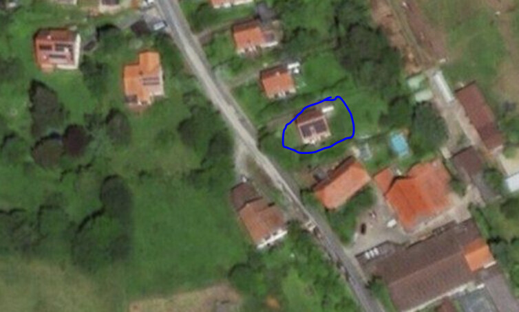

We have two options:
1) Purchasing an existing property (in the city) of unknown type and on an unknown plot of land. In the area where we are looking, the land is generally flat. We would want or have to renovate in this case.
2) A 1,950 sqm (0.48 acre) plot (5 km (3 miles) outside the city) with a relatively small existing building on the plot:
- The plot itself measures 19 x 50 m (62 x 164 ft). The short sides border a (quiet) street (SW) and a riding stable (or a field) (NE). On the long sides, there is a neighbor to the NW and a farmyard (no livestock—riding school) to the SE.
- 110 sqm (1,184 sq ft) of living space
- Partly basemented
- 1 full floor with a pitched roof
- Dimensions approximately 9 x 8 m (30 x 26 ft)
- Garage directly on the property boundary with the neighbor
- Built in 1963
- Photovoltaic system installed on the roof in 2010
- Roof replaced in 2006
- Oil heating
- Originally designed as an architect’s house
In both cases, we are looking for a home for 4 people, frequent guests, and approximately 3 days a week of home office. Roughly estimated, we need about 180 sqm (1,938 sq ft).
Option 1) is very challenging for me because it’s difficult to find a reasonable approach. For example, currently, existing properties in a size that could be adapted to our needs through renovation cost between 500,000 and 700,000 euros, including purchase-related costs. Our total budget allows for 200,000 to 400,000 euros for renovations. If, for example, architectural fees of around 100,000 euros would be incurred, we might have to exclude some properties from the start. Would it make sense here to consult an architect early on, discuss our requirements, and then take them along for a (second) viewing?
For option 2), it would of course be ideal if parts of the existing building could continue to be used, such as the basement, the photovoltaic system, and possibly the garage. I could imagine an extension in the same style, but that would naturally be left to the professional.

Regarding point 2), many aspects sound like outdoor areas to me – which raises the question of what a non-builder (or the current operator of the riding stable) would be allowed or required to do there. This could potentially be more decisive than what an architect might observe during a joint inspection.
Oh sorry, not 1950, but 950 sqm (10,230 sq ft) plot.
It is a typical residential area; the zoning plan was repealed in 2012, so now construction follows the pattern of the neighborhood.
The question of whether the architect should join us applies more to option 1. For option 2) the land already belongs to us, so we can approach it more casually.
