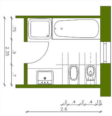

our house handover has now almost been completed, and after the site manager left, I finally used our new toilet... what can I say: I can’t move my right hand "backward" because the toilet is only 13 cm (5 inches) away from the wall, and, for example, my husband with broad shoulders actually touches the wall.
The layout plans did not include measurements for the position of fixtures, and at no point was it clear to us that there might be a minor planning error. In my opinion, the framework for the toilet could certainly have been shifted slightly to the right toward the bidet to create more space from the wall.
It seems that there is no official standard for the distances of fixtures from walls, except for accessible bathrooms.
Is this considered a defect? Or did we just get unlucky?
Does anyone have any knowledge about the legal situation for us?
Thank you very much

hanghaus20233 Jan 2024 16:38The design follows the reference drawing, but 15cm (6 inches); 13cm (5 inches) is too little. Someone probably forgot to account for the plaster.
That’s why you end up sitting unevenly!
