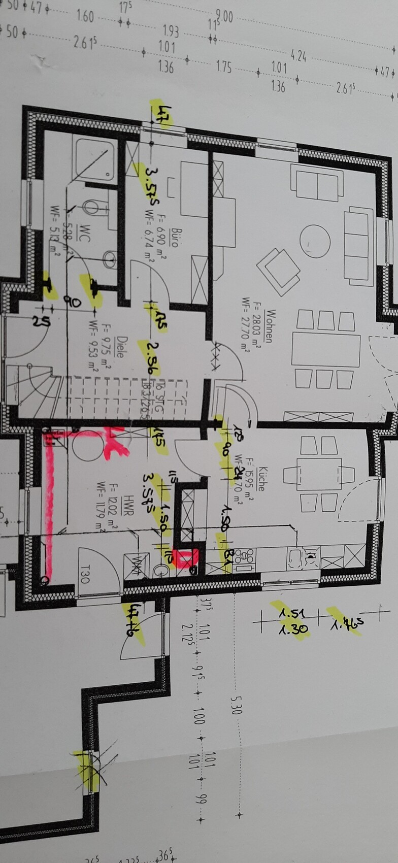

Not directly from the execution. I have attached a piping plan. The pipe route for the upstairs bathroom is marked in red. The bathroom is located directly above the utility room. In the upper right corner, “D” stands for shower. The ventilation runs from the lower right in the utility room, through the bathroom, over the attic, and out.

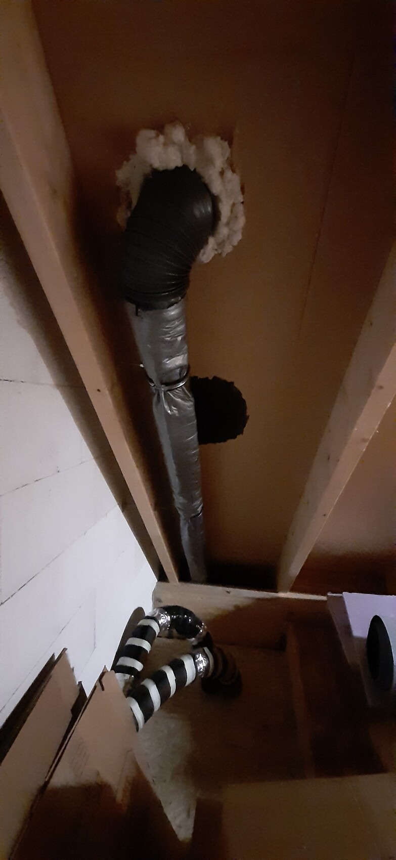

The diameter may have been chosen incorrectly for the ventilation. Without clear pictures, it is difficult to say. Alternatively, it could be that the pipe from the shower requires its own ventilation.
The second picture shows the roof or the connection to the roof vent tile? If so, I would definitely say the diameter was chosen too small.

The diameter might be incorrectly chosen for the ventilation. Without clear pictures, it’s hard to say. Also, it could be that the drain from the shower needs its own vent.
The second picture shows the roof or the connection to the roof vent tile? If so, I would definitely say the diameter is too small. Yes, the pipe indicates the ventilation. According to a tape measure, it should have a diameter of 12cm (5 inches).
