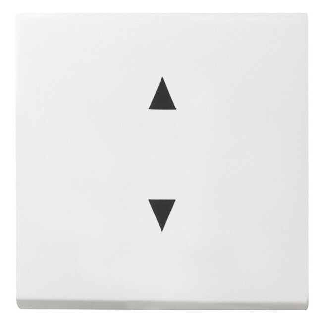

i_b_n_a_nToday, I wanted to list and order our electrical equipment and was a bit surprised that a rocker switch I wanted is not available for purchase 😳
The specialist dealer was not aware of such a switch, and according to Gira, they definitely do not have this type in their current product range.
I am looking for a rocker switch that has a single-pole normally closed contact both at the top and at the bottom—so two separate normally closed contacts. Double rocker switches or double push-buttons are available but are not what I want.
Like in the picture below (showing a rocker for a switch), I would like a single rocker with two normally closed contacts (top/bottom).
Are there any other manufacturers who currently make such switches, with a similar appearance and price range as the Gira 55 pure white glossy?
hampshire15 Jun 2021 15:33If applicable, use the Gira rocker switch together with a multiway relay in the sub-distribution board.
Hi, thanks for the feedback, but unfortunately this is not the solution (or I didn’t understand it 😉). The push buttons are connected directly (via a relay wiring setup) to the input of a Controllino Max. A momentary contact switch (only for non-dimmable lamps) would also be controlled through this. This rocker switch is intended to control individual venetian blinds up/down, and that would be our preferred solution (mainly for aesthetic reasons).
