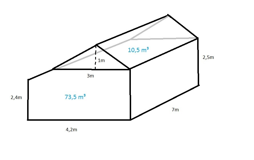

I have a detached wooden garage that is free on all sides. The garage is built as shown in the sketch. That means there is a small extension on the left side, which is directly connected to the garage space – basically enlarging the “original garage.” On top of that is a gable roof … see the sketch. The roof is directly connected to the garage room – so it’s basically one large space. There is no separate attic floor dividing the garage into two rooms!
The goal: I want to be able to work in my garage during winter/autumn without freezing. So the garage needs to be insulated. That’s no problem – I was thinking of using 100mm (4 inches) thick Neopor for insulation. The heat source would be a medium-sized stove with fireclay bricks.
Now the question:
Option 1: I leave the garage as it is and insulate it completely: exterior walls + roof. Then I have an 84m³ (2,965 ft³) space to heat – the warm air first goes up to the roof and only slowly comes back down.
Option 2: I build a conventional attic floor, meaning a ceiling that separates the roof from the garage space and insulate that normally – then I would only have 73.5m³ (2,595 ft³) of space to heat.
-> It’s clear that option 2 is better energy-wise! The warm air doesn’t just collect “uselessly” under the roof and it heats up faster. However, option 2 is much more expensive because you first have to build the attic floor. So, with option 1, could you say “Yes, you just have to wait 5 minutes longer for it to get warm,” or is the difference really significant? In other words, is installing the attic floor worth it?
I’d appreciate any advice and especially any experience!

I understand your point. Although the garage is large, it’s more like a boat shed. The previous owner built it “okay,” but it’s not particularly airtight. So insulating it would kill two birds with one stone: it would make it airtight, improve the exterior appearance a bit, and, as you said, help with heat retention... Heating with a lot of wood in its current state would really just mean the heat goes straight out through the roof. Can you explain exactly what you mean by condensation?
Best regards!
Currently, the plan is to insulate the roof from the inside with Neopor – this way, the expensive cladding can be avoided. On the outside, it will be done as usual with polystyrene and tongue-and-groove timber. The floor will still be installed. The problem with option 2 is that the hatches to the floor could only be opened slightly – which would be quite fiddly. I will probably have to wait about 5 minutes each time.
