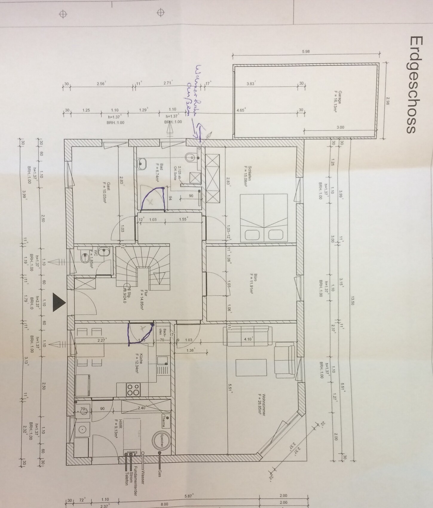

Since we are people who like being outdoors, doing things ourselves, and occasionally getting dirty, we chose a back door that leads into the utility room. Aside from the usual technical equipment, it houses shoes, the washing machine, and an enamel sink with hot and cold water. Since there is water anyway because of the washing machine, having a sink is useful for things like washing potatoes or scrubbing very dirty paws, among other uses. Additionally, since we didn’t want to afford a basement, we converted the attic. We fully lined it with tongue-and-groove boards, insulated it with glass wool, and made it accessible with a proper staircase—not just a pull-down ladder. Up there we have electricity, lighting, an openable Velux window, and shelves. A very worthwhile investment. During the winter lockdown, the attic also became our private Pilates studio with a mat, bench, small weights, and a stability ball.Even though this post is a bit older, we want to use our utility room similarly but without a sink. How large did you plan yours? We are currently planning for 7–8 sq meters (75–86 sq ft). It should accommodate all the technical equipment (air-to-water heat pump, external 250-liter (66-gallon) water storage tank, ventilation system, electronics, etc.). Additionally, if necessary, we want to dry laundry there and store shoes. We also want to keep some daily items like a vacuum cleaner. Is 8 sq meters (86 sq ft) enough for that?
Hausbauer202129 Mar 2021 10:46Nordlys schrieb:
According to the plan, it has 9.1 sqm (98 sq ft). I think 8 sqm (86 sq ft) is very tight. Try to get a bit more out of it.Ok, thanks, then 7.5 sqm (81 sq ft) is not too far off. Thanks!M
motorradsilke29 Mar 2021 13:06Hausbauer2021 schrieb:
Even though this post is a bit older, we want to use our utility room in a similar way but without a sink. How large did you plan yours? We are currently planning with 7-8 sqm (75-86 sq ft). It should accommodate all the technical equipment (air-to-water heat pump, external water storage 250 liters (66 gallons), ventilation system, electronics, etc.). Additionally, if necessary, we want to dry laundry there and also store shoes. Also, a few daily items like a vacuum cleaner. Is 8 sqm (86 sq ft) enough for that?I would reconsider the sink. With a washing machine, you always need a basin to rinse or soak things from time to time. Washing dirty shoes, for example. Maybe you could try to get a combined heat pump and water storage unit? That might save you some space.When planning the utility room, it is important to ensure it has proper ventilation and windows, a good connection to the kitchen, and preferably an exterior door, so it can serve as a mudroom. Ours is designed as follows: the back wall houses a large closet full of winter coats and similar items; next to it is the water tank for the solar system. The front wall opposite contains the washing machine, dryer, and sink, as water is already available there. Above the machines is a window. The wall facing the kitchen has a door leading there, beside which is a pantry cabinet for canned goods, cleaning supplies, dish towels, brushes, and paint, as well as bottles of liquor and juice. Cat food and feeding bowls are also stored there. Next to that is space for the cat’s litter box, a fold-away drying rack, and a step ladder.
One wall opposite the previously mentioned one is left free for technical equipment: the heating boiler, electrical cabinet, telecom modem, with valves and meters for reading underneath. Our shoes currently in use stand on the floor in front of this. Next to all that is the door to the garden.
