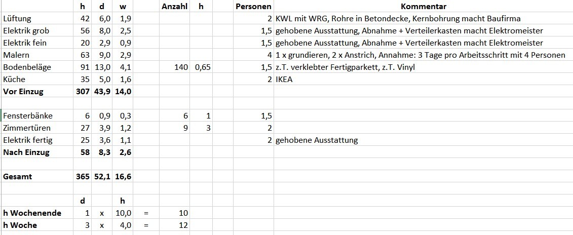

today I would like to ask you again for what you do best: bringing a layperson’s naive ideas back down to reality.
I hope the attached calculation is at least somewhat self-explanatory. It might be worth mentioning that in the estimates (h=hours, d=days, w=weeks) I have already taken the number of helpers into account. So these are not man-hours/days/weeks.
Many of you probably have more practical experience: would you consider these figures roughly realistic? Most of the tasks (those listed with 1.5 people) I will do more or less alone, with my wife as an assistant. There might be more active helpers, but I’m not counting on that for now. At least for the trades involved, I’m reasonably skilled but not exactly fast—at least until I get into a routine, then I can speed up quite a bit.
