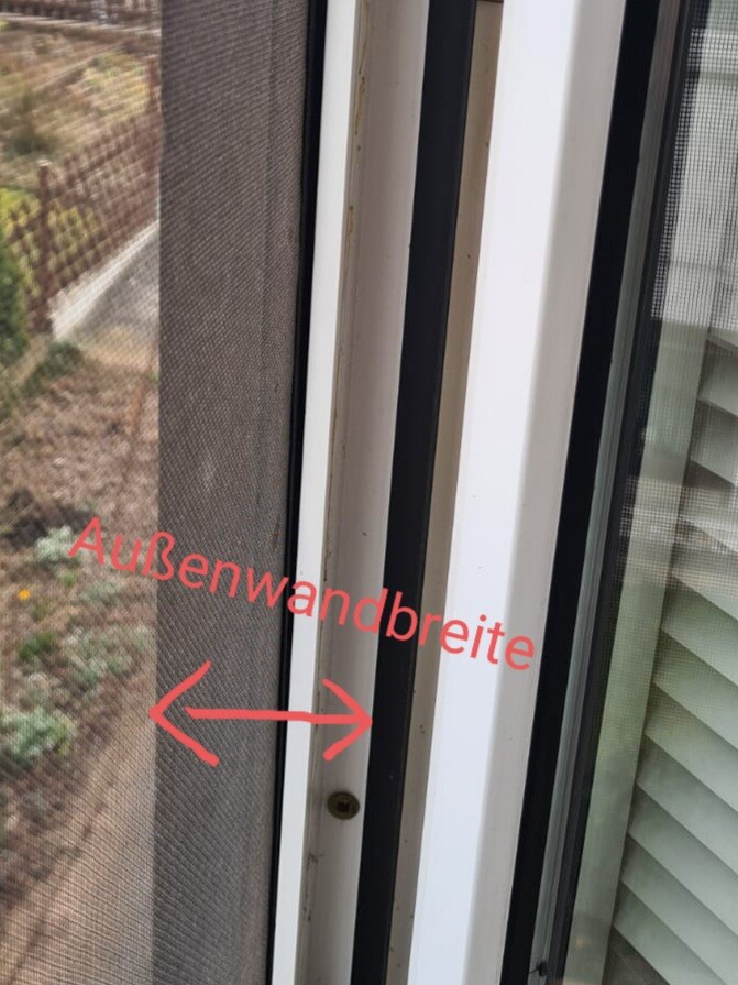

tomtom79 schrieb:
That looks more like a 20-25cm (8-10 inch) wall.
But where can you get such nice houses for this price?

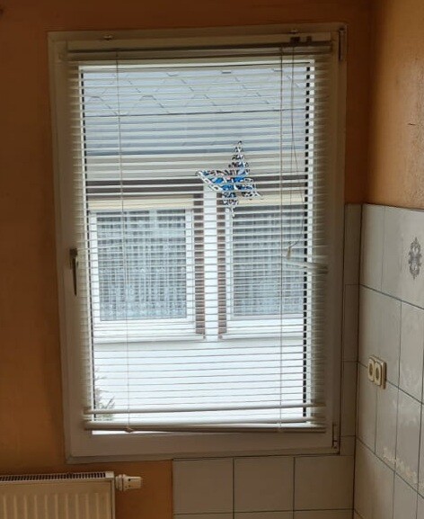

Please take another look from a different perspective.
The windows are slightly recessed inward.
