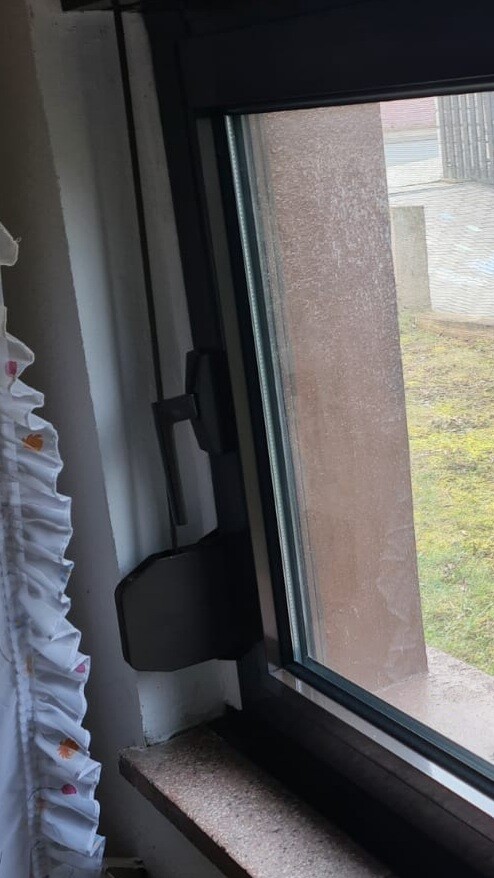

Unfortunately, not right now. I only have that one photo, which gives a rough idea of the wall thickness.

Inside window with black handle, curtain on the left, view outside on brown wall and green area.
