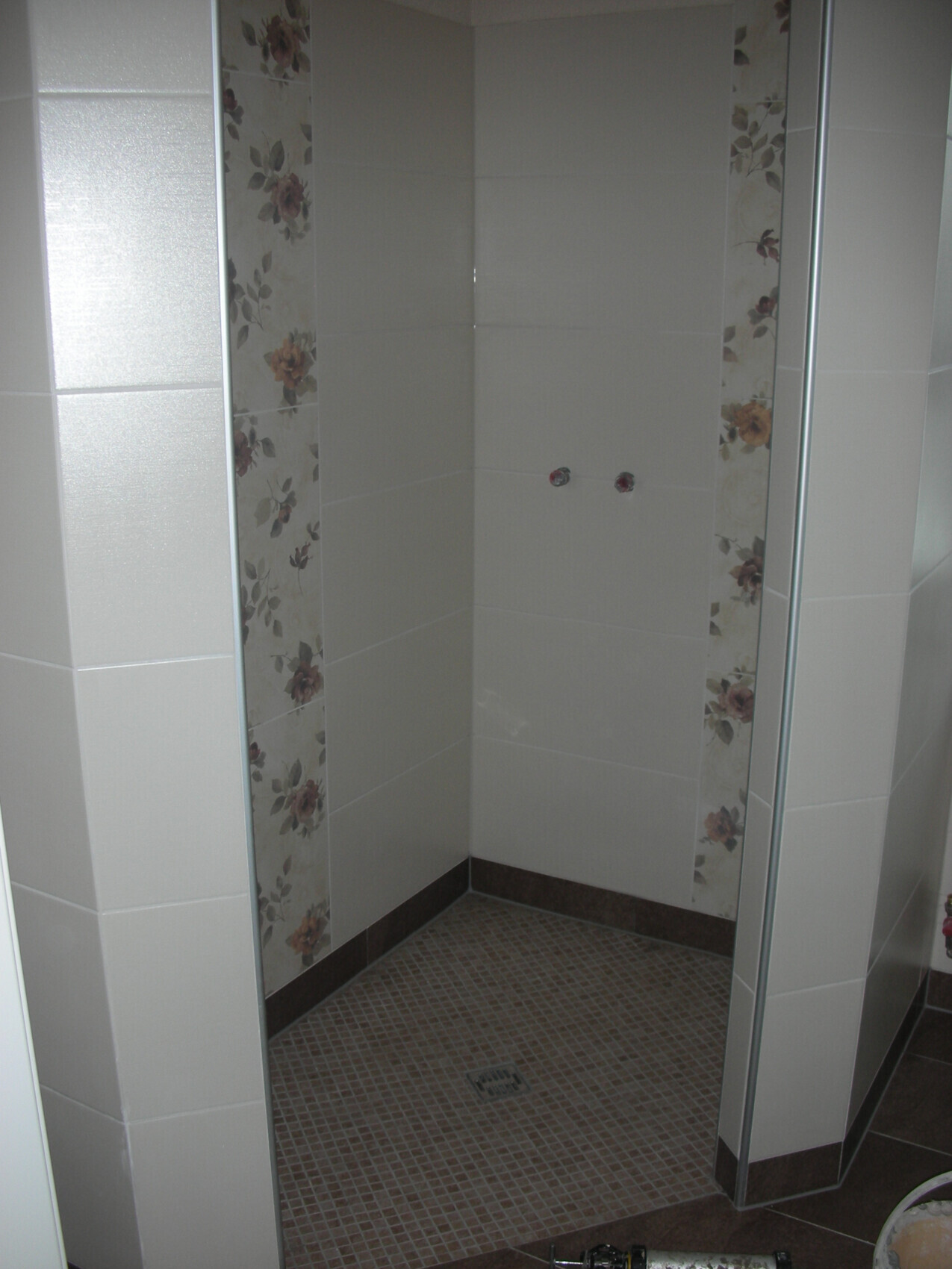

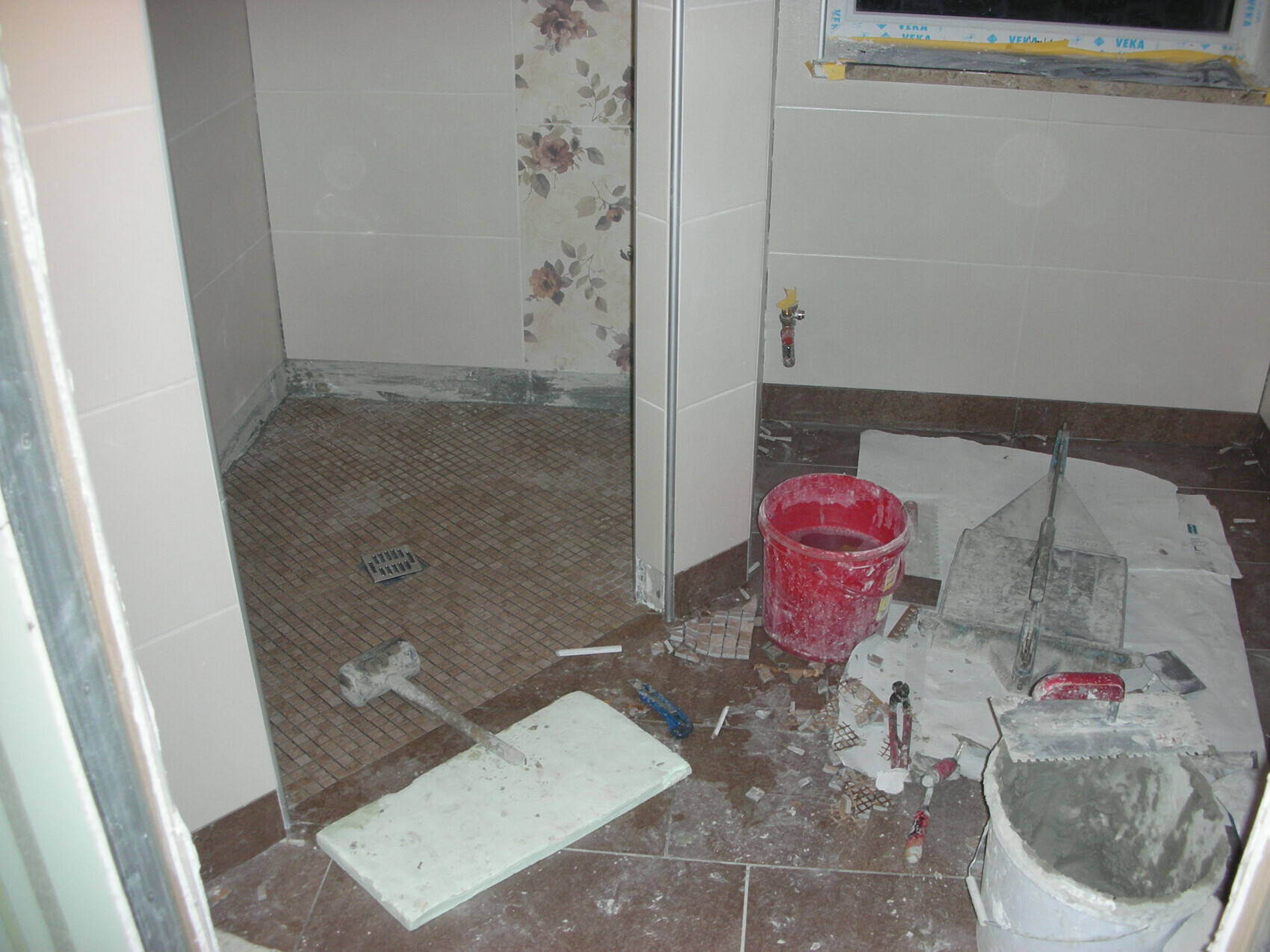

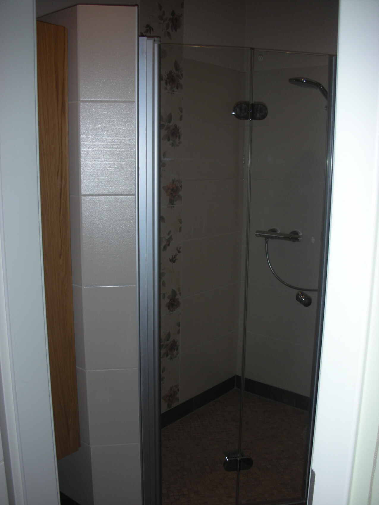

I’m wondering how it will look since we have 60x60 cm (24x24 inches) tiles on the floor, but in the shower area we want to install a herringbone pattern with 30x7.5 cm (12x3 inches) tiles. Huh... herringbone in the shower area?
From my construction phase, it looks like this… however, I have a central square drain about 10x10 or 11x11 cm (4x4 or 4.3x4.3 inches) and 30x60 cm (12x24 inches) tiles all around:
