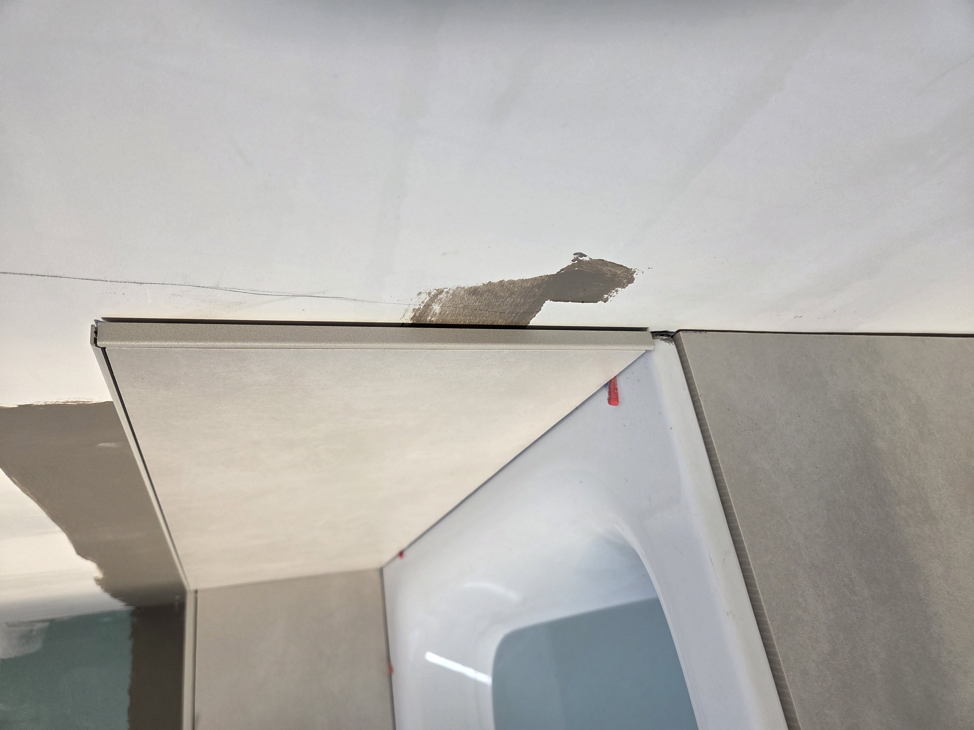

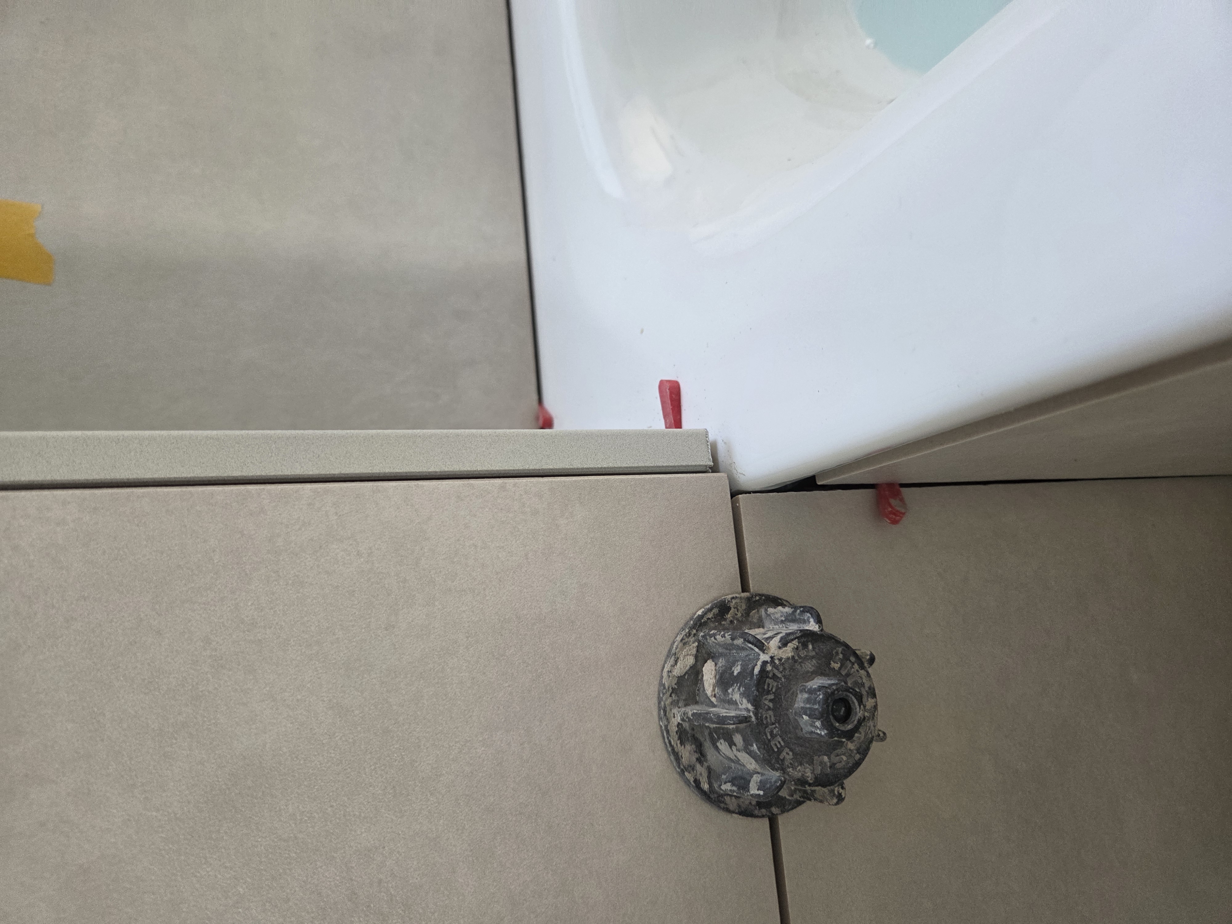

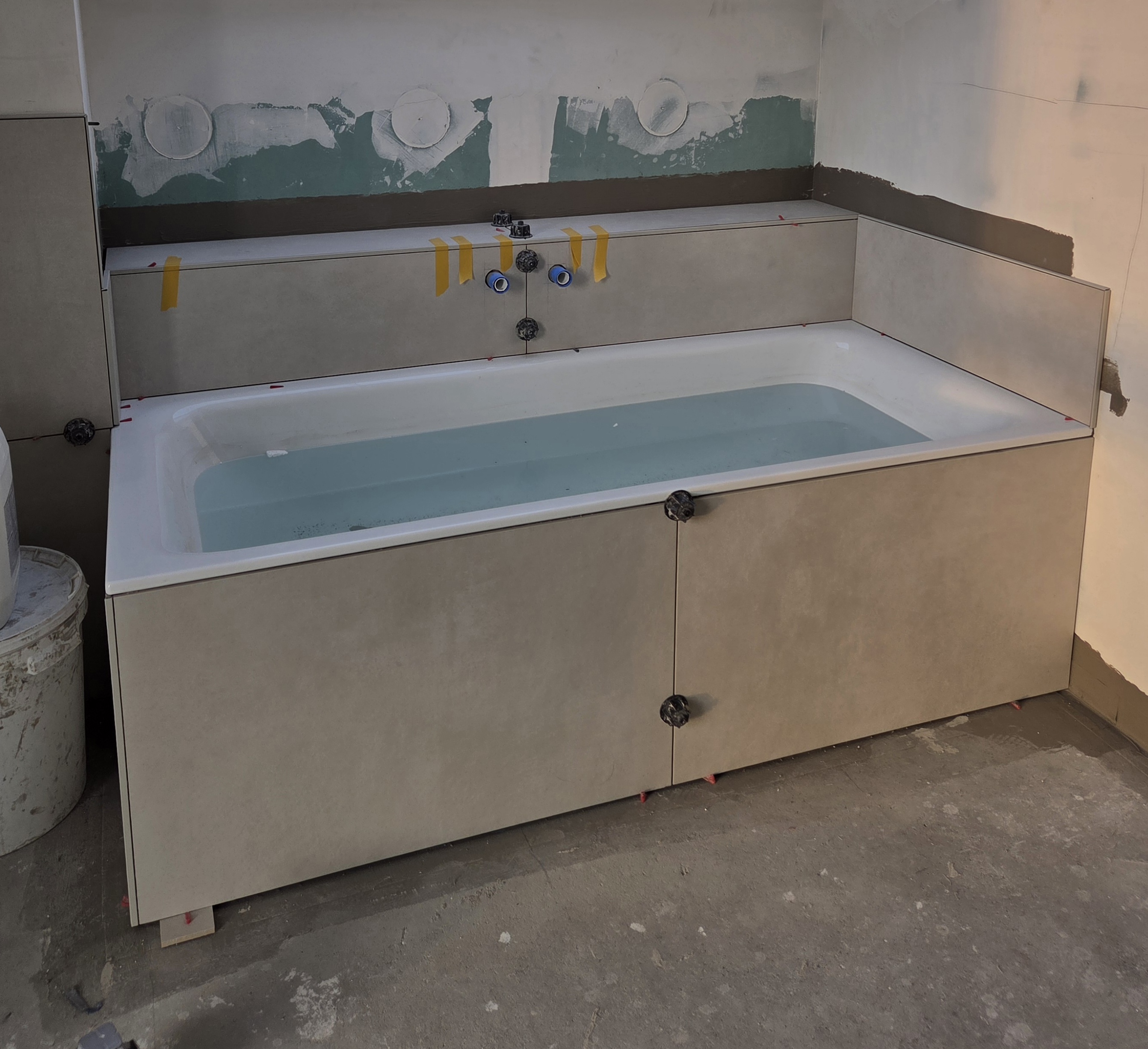

We are constructing a new building with a general contractor who is managing all trades. Despite our instructions and prior bathroom planning, the trades involved in the bathroom did not coordinate properly: the plumber did not provide the measurements for the bathtub, the drywall installer made the niche for the bathtub too small, and although the tub fits, the tiles around it no longer do.
The tiler then simply placed the tile on the edge of the bathtub, which does not look reasonable at all. Does anyone have experience with this and can tell me:

RobertHell17 Jan 2026 21:45So, one of the tilers may have done the work here, but he clearly has no plan.
He should have reported the defect to the following trades; now it will get expensive. Who is responsible for the structural inspection?
So, report the defect and demand correction.

RobertHell18 Jan 2026 22:53I usually agree with that too – however, it’s by no means the only thing that went wrong for us. We approved almost everything and are slowly losing the willingness to pay a lot of money and just accept everything as it is. Especially for the additional tiling work in the bathroom, there were exorbitant prices involved.
Maybe there is a simple and cost-effective solution, and someone has an idea: For example, removing the tiles above the bathtub and painting with a waterproof membrane? We are very bothered by image 1 (edges and tiled bathtub rim).
