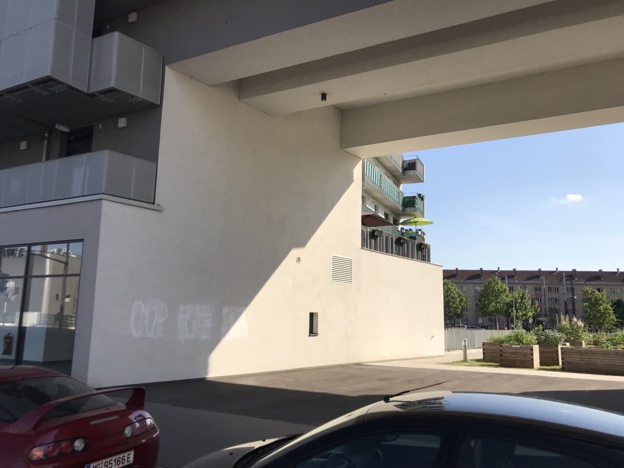

Overall, the continuous tiling area is about 30 square meters (approximately 1.8 x 17 meters or 6.3 x 4.4 meters), either lengthwise or heightwise. A plaster surface of 30 square meters (approximately 1,800 square feet) means a lot of material to remove by knocking it off, but on the other hand: should the tiling be applied on top instead?
Please show the relevant facade and what is planned to be applied there.
Karsten B1 Sep 2021 15:2211ant schrieb:
30 m² (320 ft²) of plaster surface is on one hand a lot to chip away, but on the other hand: would it be better to apply the tiles instead?

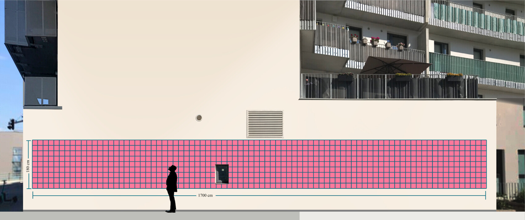

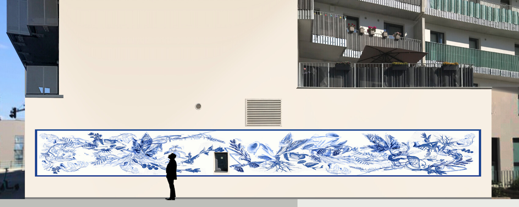

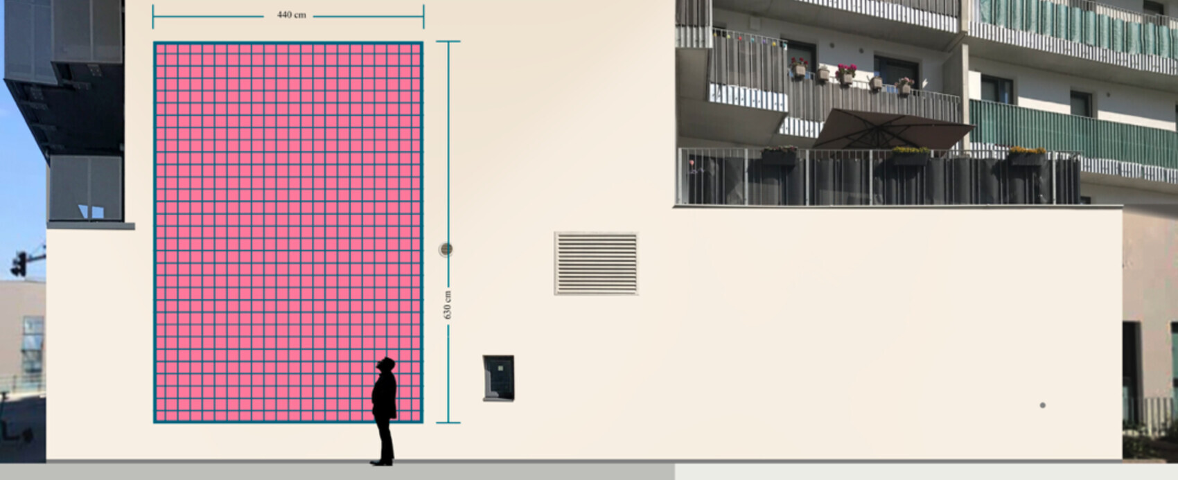

Please show the relevant facade and what is supposed to go on it. Here are the photos.
Thanks for the quick responses.
Whether to use portrait or landscape format is not yet decided. The tiles will form a continuous image. The drafts are only meant to give an impression and will be redrawn once I have all the necessary information.
