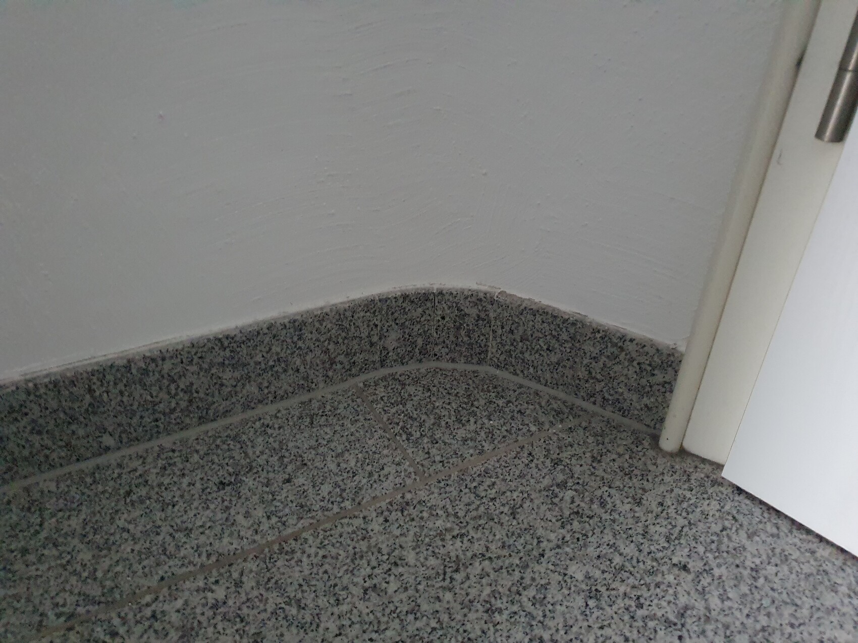

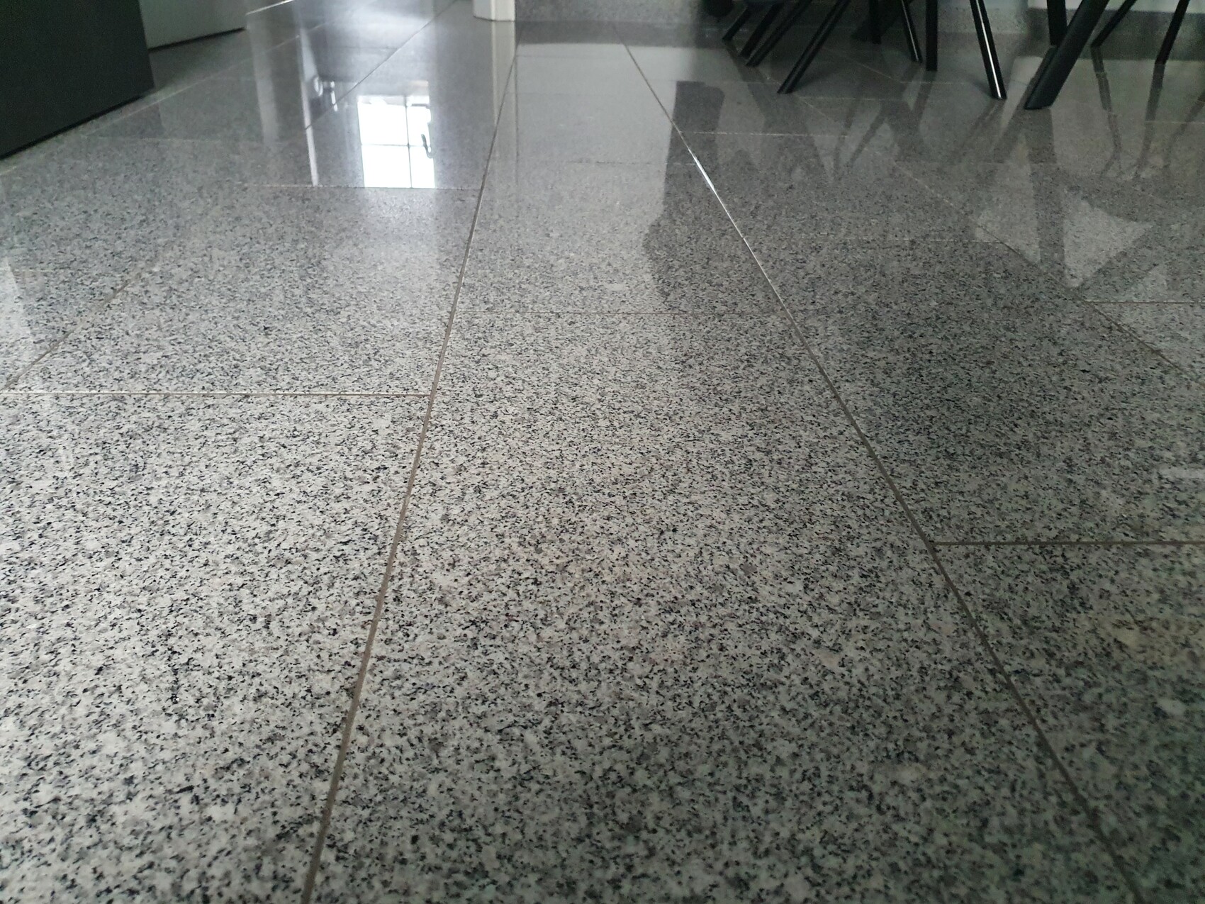

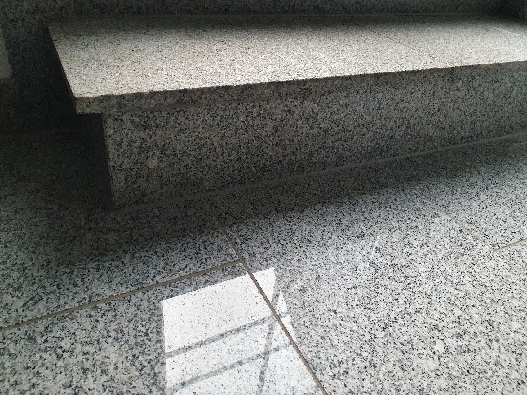

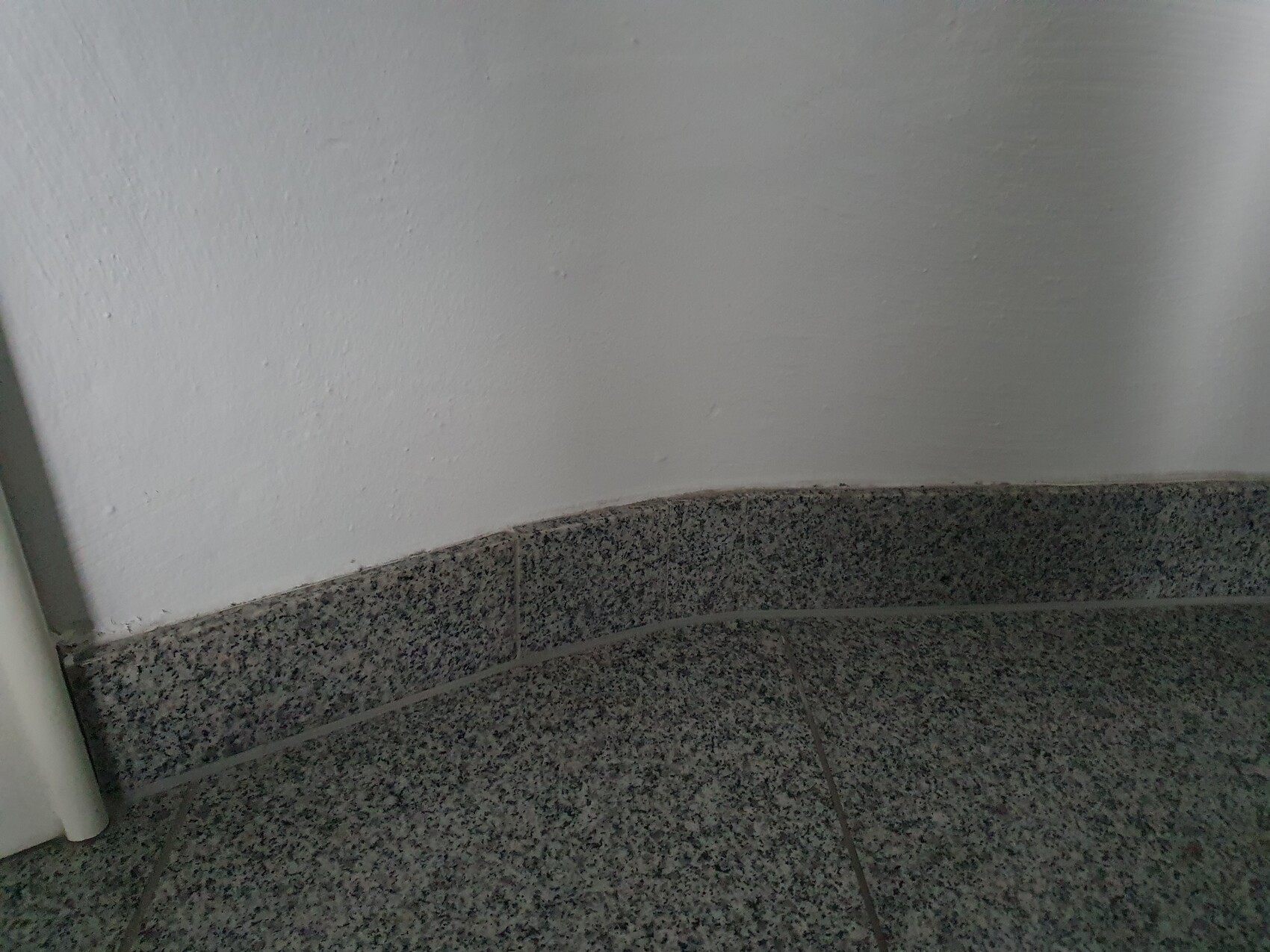

pagoni202021 Sep 2021 23:10Tschitschi schrieb:
I hope you understand what I mean. Do you have some pictures?

Tschitschi23 Sep 2021 18:42pagoni2020 schrieb:
Do you have any pictures?hampshire schrieb:
