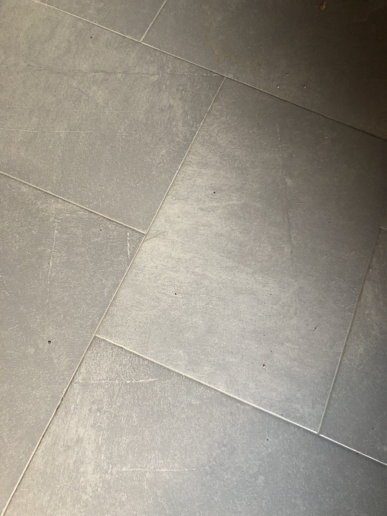

exto1791 schrieb:
Are 10€/m² (approximately $10.50 per sq. yd.) tiles from a hardware store any good?Yes, they can be used. We also installed them in the garage. The baseboard tiles are relatively “expensive” compared to that.
