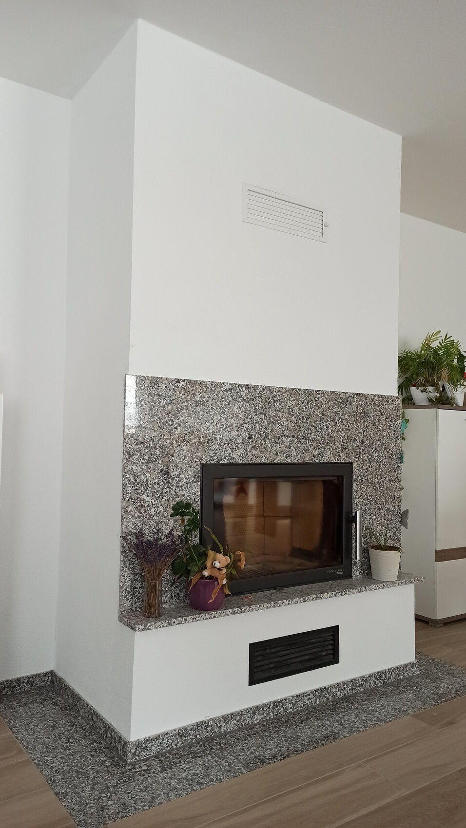

I have a Haas & Sohn Komfort IV 8 kW (8,000 BTU). I installed it myself and clad it with Knauf red lime boards made of perlite. The insert cost about 1,200€ (euros), and the ventilation grille, inspection door for the temperature sensor, underpressure monitor, special mesh, boards, and plaster were about 1,000€ (euros).
The insert is just for fun and not comparable to a heat pump.
Attached is a photo.
