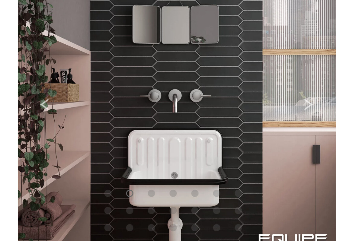

27 May 2022 21:32
Is it this one? And placed vertically?
Draw a line with a pencil, score it with a tile cutter, and break it off using pliers or tap it off with a hammer. Tile cutters can usually be borrowed.
A few millimeters will be covered with a silicone sealant joint.
Kleines weißes Waschbecken vor schwarzer Hexagonfliesen-Wand, Armatur, links Pflanzregal.

Yes, these are the tiles. I have a manual tile cutter here. Still, breaking along the scored line doesn’t come out as cleanly as it should. The tiles are quite thick; maybe that’s the reason?
