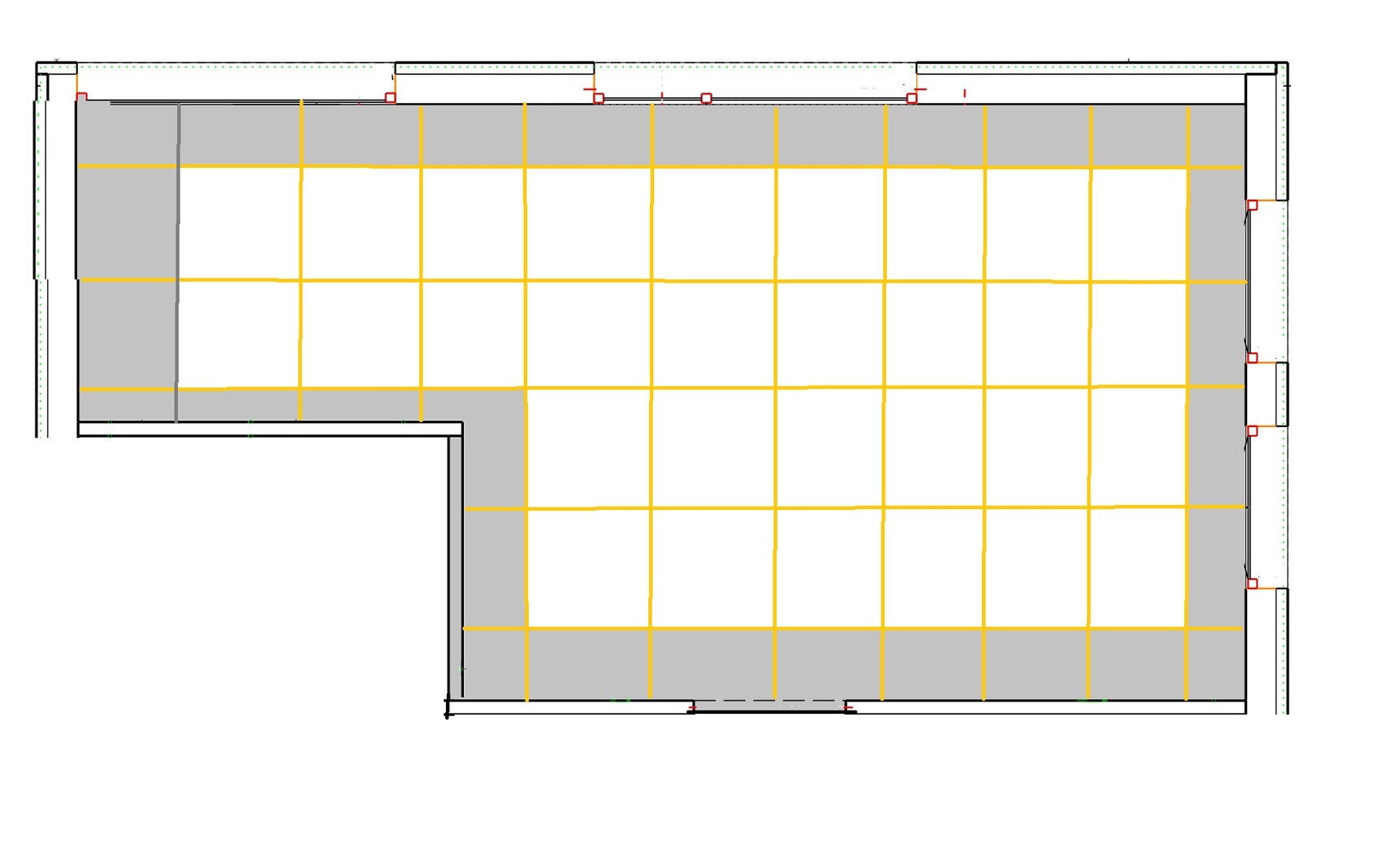

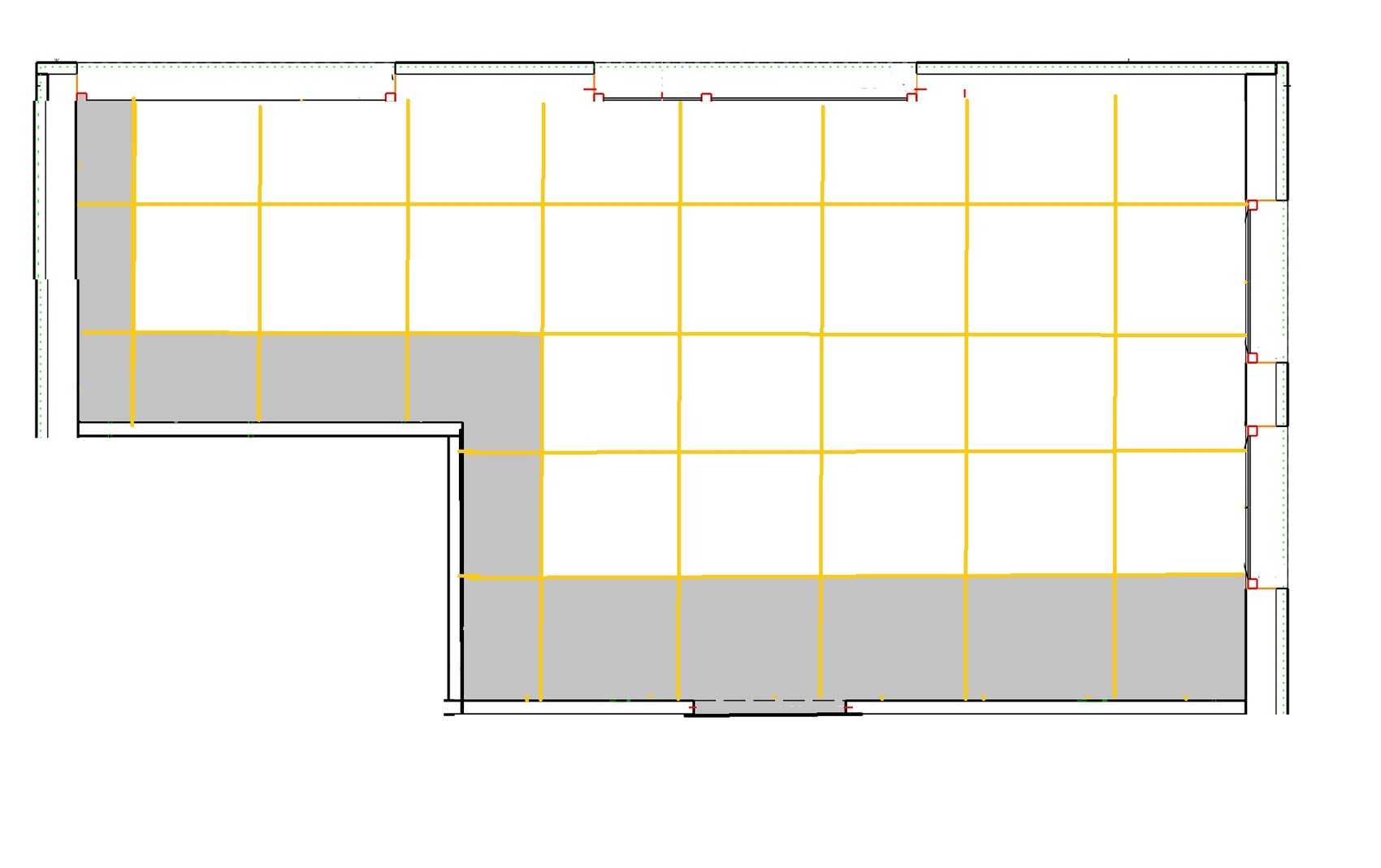

Our tiles are 1000 x 1000 mm (39 x 39 inches) with 2 mm (0.08 inches) grout lines. We plan to install them in a straight joint pattern. Normally, as I understand it, you start from the center of the room and work outwards, with cut pieces at the edges (Option 1). However, a friend advised us to start from one wall instead, so that the cuts only appear along the opposite wall (preferably the wall where shelves, sofas, or tables will be placed), which would be Option 2. His reasoning was that this would make the cuts less noticeable.
I roughly sketched both options, not to scale, with the gray areas representing the cut pieces. The room measures 11 m x 5.6 m (36 x 18 feet).
What are your thoughts? How would you install such large tiles?
