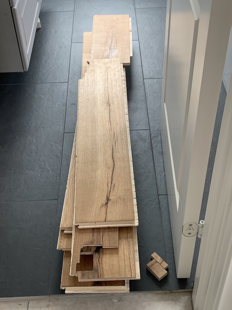

Here you can see the direction more clearly:
Several wooden floor panels stacked in the hallway next to a door.

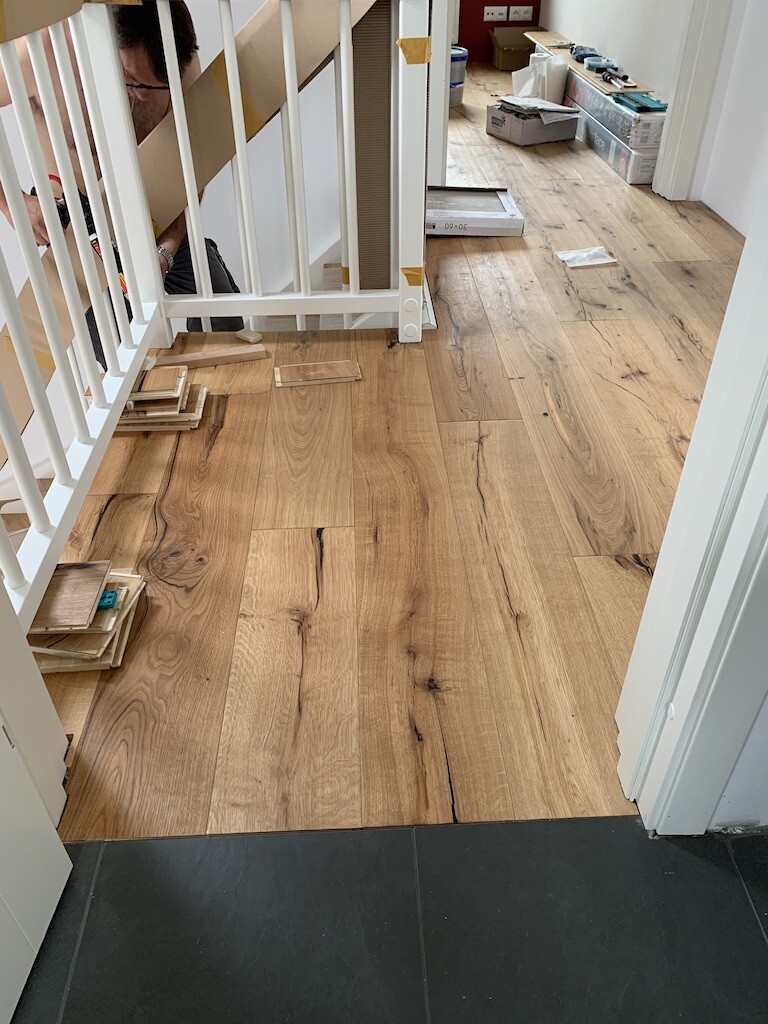

And here is the transition from the bathroom to the hallway.
Person laying wooden flooring next to stair railing; building materials and tools are in the room
We laid out each row on site and then decided immediately...

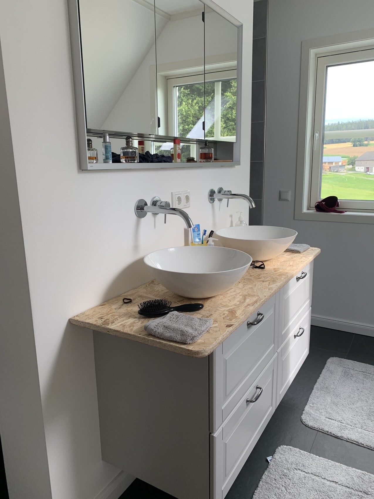

We only painted the tall exterior wall
Double basin wash area with white basins on OSB table, mirror, fittings, window with landscape view
(the washbasin countertop is temporary)
