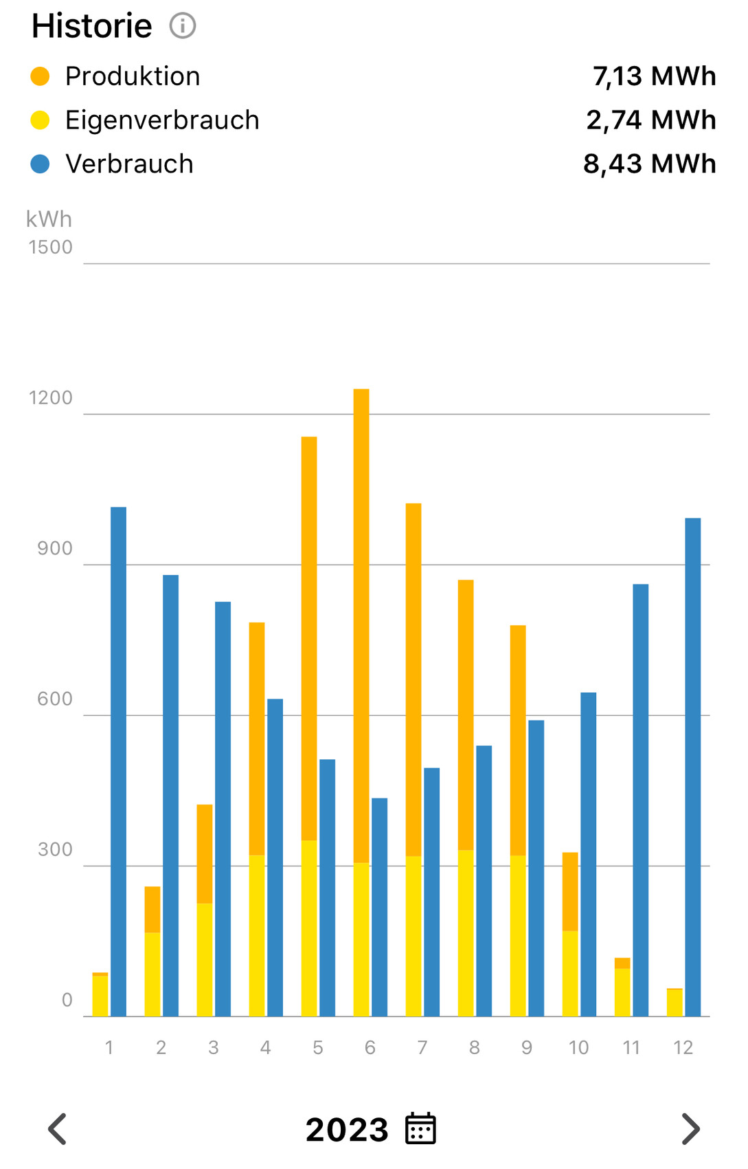

Our load curve last year looked like this:
Our electric car used just over 200 kWh per month on average. I can fairly reliably shift that to cheaper daytime hours. The heat pump, on the other hand, runs quite constantly.
Right now, I have blackout periods from 10 p.m. to 5 a.m., which are overridden by Vaillant controls when temperatures drop below 4°C (39°F). If I shift them to 5 p.m. to midnight, that should have the same effect on cycling. But it would probably consume more electricity since mornings tend to get colder?
It’s not an easy decision. After all, we currently pay only 28.5 cents.
