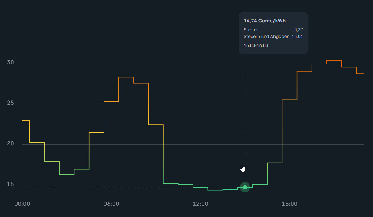

WilderSueden3 Jul 2023 15:39kati1337 schrieb:
Where are people getting the 7¢ surcharge for Tibber? According to their website, they don’t charge for consumption, only a monthly fee of €4.90 and a one-time cost for the Pulse device of €100–150. I got the 7¢ from @jrth2151. But Tibber mentions something closer to 15¢ for taxes and fees here, which would make self-generated electricity even more advantageous.
Honestly, I’m not quite sure about the graph. It says “today’s price” on top, but the day isn’t over yet? That would fit pretty well with the day-ahead pricing. But then that would actually be the electricity price for tomorrow, not for today?
WilderSueden schrieb:
To be honest, I don’t really understand the chart. It says "today’s price" at the top, but the day isn’t over yet? That would fit quite well with the day-ahead market. But then it would be the electricity price for tomorrow, not for today?The way it works is that from 1 PM onwards, they publish the prices for the following day. Then you can decide what to do. For example, yesterday it wasn’t like people saw "oh! If I draw electricity now, I get 48 cents!" — you actually find that out one day in advance.
In the chart above, you’re right, using solar power is still cheaper than drawing from the Tibber grid. But what I’m really interested in are scenarios — which have started to happen occasionally — where the electricity price drops so far into negative territory that after taxes and fees, you actually get paid to consume electricity. That’s what happened yesterday afternoon, for example, with something over 40 cents per kWh.
