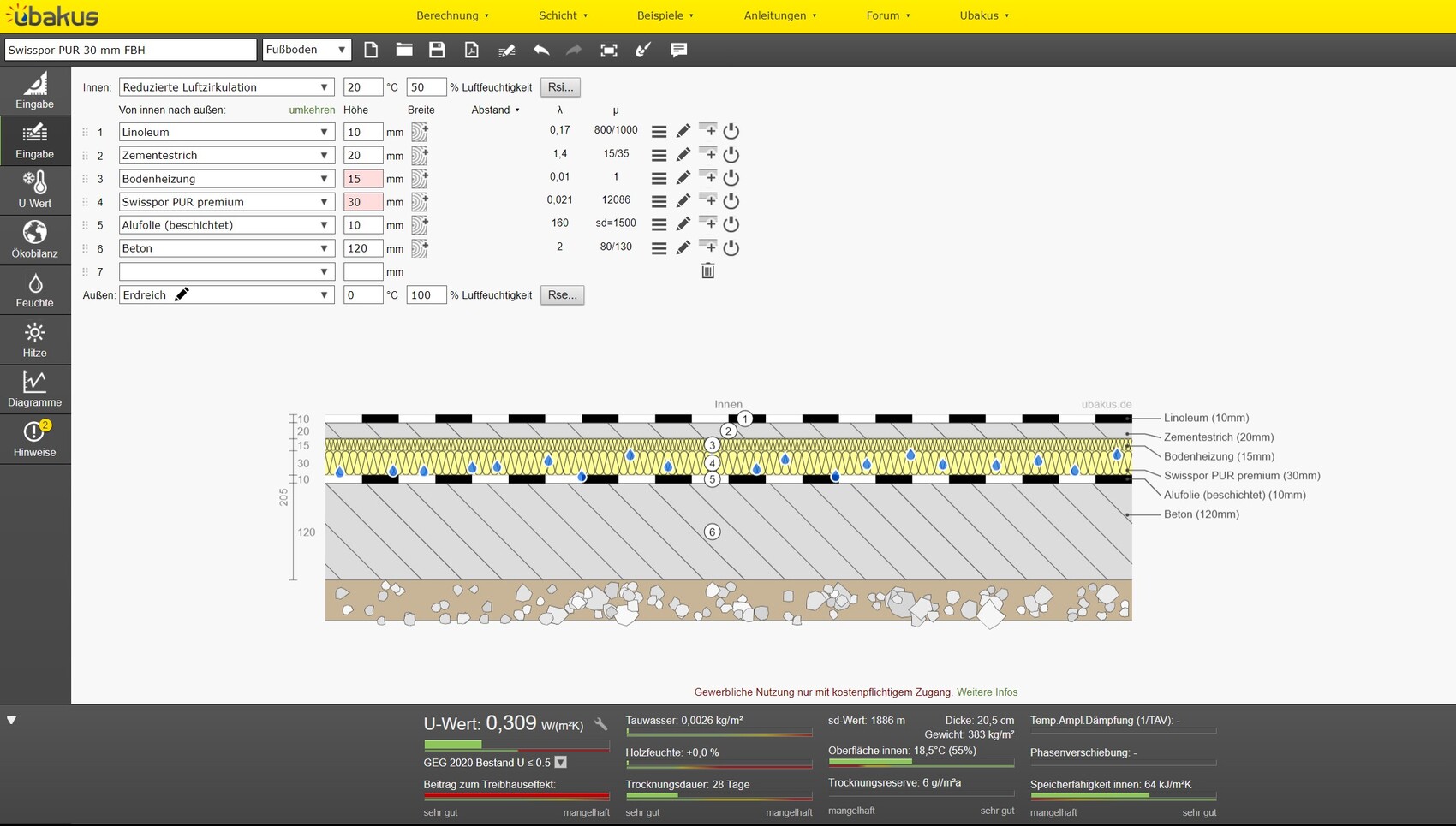

Swisspor PIR Premium 0.018 or Bauder WLG022 are currently unavailable anywhere, which is worrying me.
What also concerns me are the blue drops in the Ubakus calculator, probably due to the water vapor diffusion resistance factor.
An alternative could be Foamglas boards, but their insulation performance is not as good. I even looked into Spaceloft Aerogel but am unsure if it is suitable for floors (strength). What is appealing about the Turbolight screed systems is that, in theory, you could install standard 16mm (5/8 inch) underfloor heating pipes.
Benutzer2001 Jan 2022 19:01What do you need 10mm (0.4 inches) aluminum foil for? You already have aluminum-laminated PUR foam.
I thought a vapor barrier (aluminum-bitumen) is necessary to prevent any moisture (condensation) from being released. It is currently installed under the old screed. For foam glass, it would be overdue, but unfortunately, the U-values of foam glass at the same thickness are twice as poor as those of PIR.
