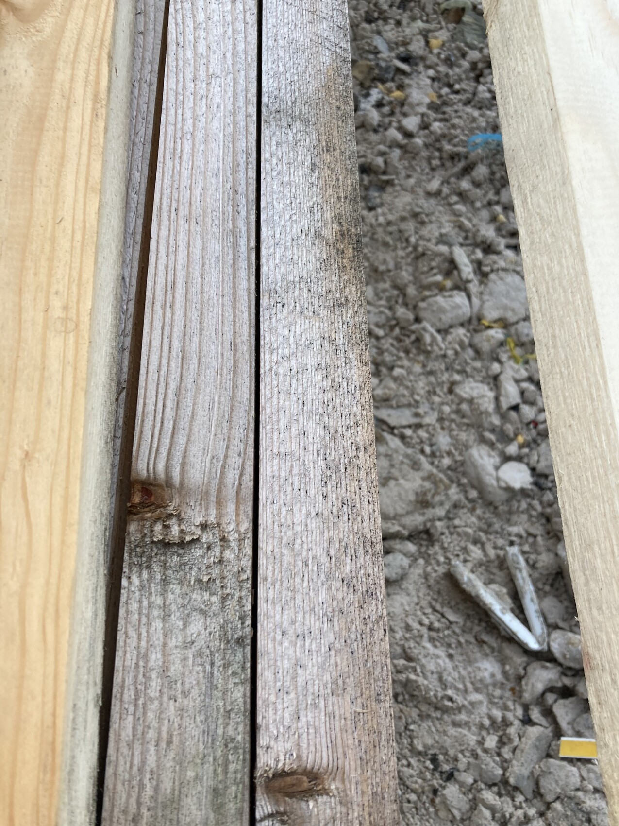

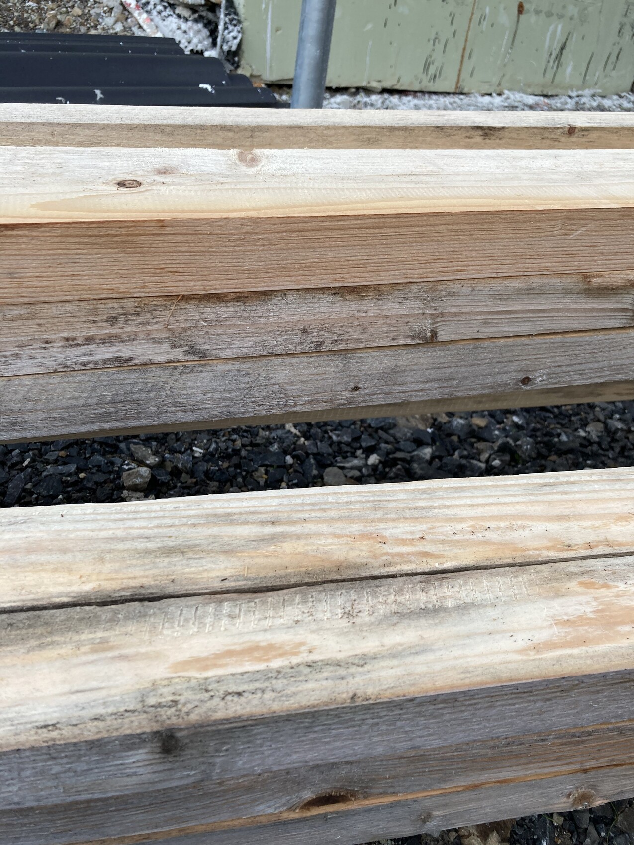

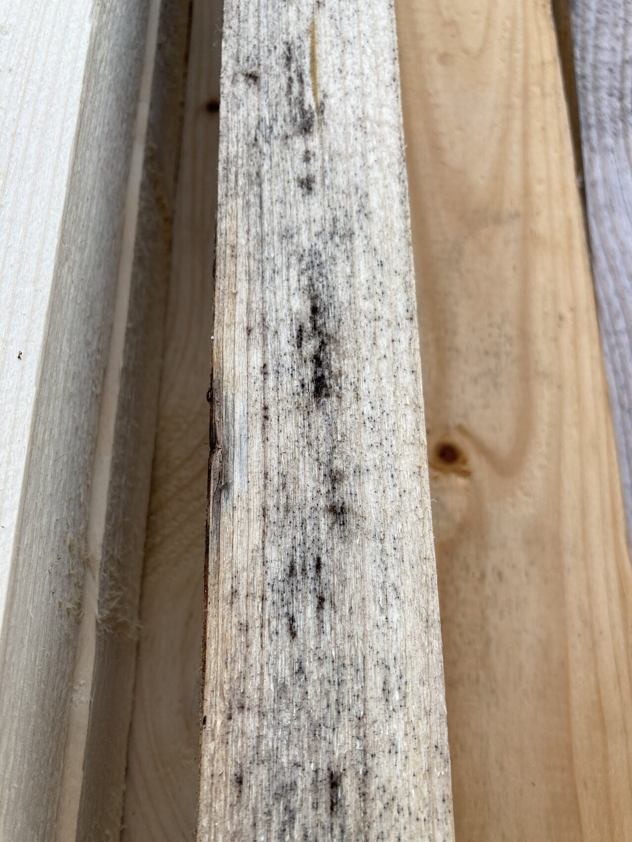

I just received my wooden battens for the substructure of the rough decking. Unfortunately, they look somewhat “off.” I checked by feel, and they all seem dry. Now my question is: can I install them like this in the attic (cold attic), or should I sand them beforehand? Is this mold? Attached are a few photos.

Try searching for beetle wood. Lumber from trees damaged by bark beetles may have discoloration, but is otherwise fully usable in terms of quality. Distinguishing it reliably from mold-affected wood in close-up photos online is beyond my crystal ball.

The gray areas are fine; that is weathering. The black areas are mold, even if someone might see it differently.

Okay, thanks. So there are no concerns if he gives me some from the back part? The battens were probably stored somewhere damp at times… I just looked at beetle-infested wood, but it looks quite different. Still, thanks for the tip.

Well, you have to check yourself if there is any mold. You can usually tell by looking. Storing the wood outside is not a problem, but of course you don’t want to use moldy wood in the roof.

I’m quite certain this is not beetlewood; it really looks different. These are stain spots, basically fungal growth, which in the form of small dots does not yet damage the wood. It appears very quickly when freshly cut and sawn wood cannot dry properly. This usually happens when wood is stored without spacers between layers, especially outdoors. It mostly affects the sapwood but can also spread to the heartwood.
In visible areas, you can remove it – as you would at home – using mold and algae remover, washing soda, or lime-based cleaner (alkaline, NOT acidic!). It will not reappear as long as the wood is properly installed or stored. At this stage, there are no structural limitations, but I would not use it for living room paneling.

Perfect, thank you. As I said, these will be replaced tomorrow with the “good” ones. If there are still individual spots left, I will proceed as you described. Many thanks to everyone!
