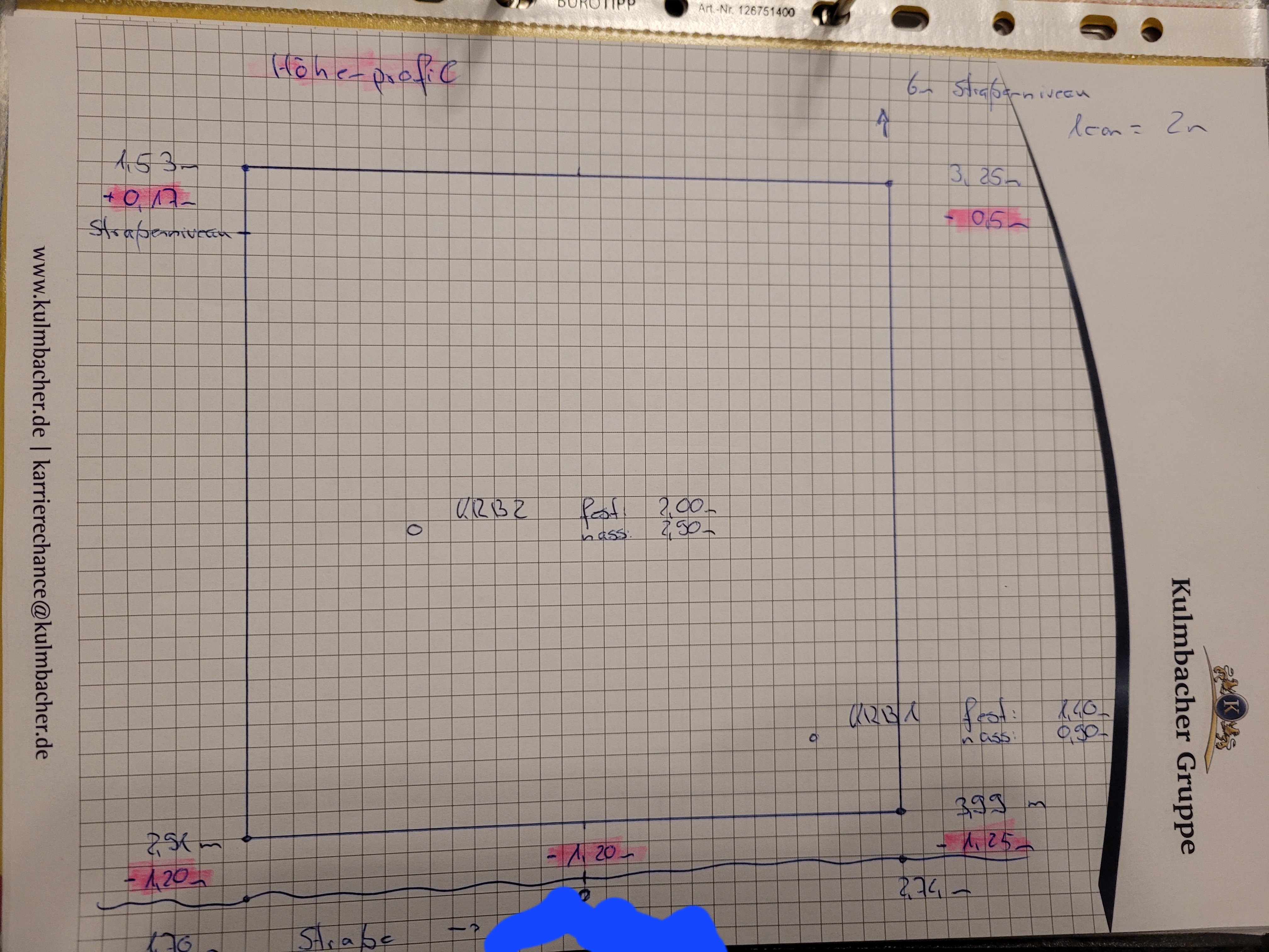

Information about the plot:
- not yet developed
- 900m² (9,688 ft²) area
- street at the property has about a 3% slope
- the plot has the same slope where it borders the street
- the plot is located about 1.2 meters (4 feet) below street level on the north side (street side)
- the land rises towards the south/back, reaching street level towards the southeast and almost towards the southwest
- the sewer line is about 1.5 meters (5 feet) below street level
- approx. 60 meters (197 feet) west is the nearest intersection with electricity, water, and possibly sewer connection (more on this below)
- a 3-chamber septic tank is required WITHOUT a treatment pond. The pond is centrally located for the village

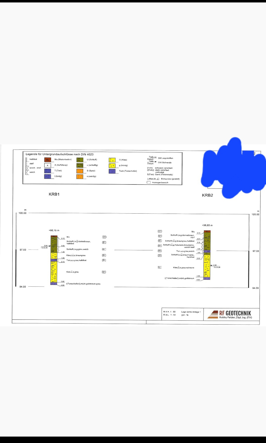

We have already had a soil inspection performed with two small percussion boreholes:
- Borehole one near the street at the lowest point: after 1.4 meters (4.6 feet) below the turf is buildable ground. Seasonal groundwater pressure starts at 0.9 meters (3 feet). So, 1.4m + 1.2m = 2.6 meters (8.5 feet) below street level is solid ground.
- Borehole two roughly in the middle of the plot: after 2 meters (6.6 feet) below the turf is buildable ground. Groundwater at 2.9 meters (9.5 feet). So, 2m + 0.7m = 2.7 meters (8.9 feet) below street level is solid ground.
In addition, we took some important height measurements, which allowed me to include the figures mentioned above.

As mentioned above, this is currently the main question for us. I’m sure it has been asked many times before, but every construction project needs to be considered individually.
My wife inherited the plot of land from her parents.
- not yet developed

Joergi schrieb:
- Borehole one near the street at the lowest point: buildable soil found after 1.4 meters (5 feet) beneath the turf. Seasonal groundwater pressure from 0.9 meters (3 feet). Solid ground 2.6 meters (8.5 feet) below street level (1.4m + 1.2m).
- Borehole two roughly in the middle of the lot: buildable soil found after 2 meters (6.5 feet) beneath the turf. Water encountered at 2.9 meters (9.5 feet). Solid ground 2.7 meters (9 feet) below street level (2m + 0.7m). Luckily, no one could see my face when I read this. Having buildable soil only two meters below the turf is usually not the kind of result you want.
If this is really the case, the question doesn’t really arise. So much soil would need to be replaced that you would essentially pay almost as much as for a basement.
In that case, you might as well just build the basement from the start.
(I’m usually not a fan of basements unless the plot is on a slope. This is one of the few exceptions.)
