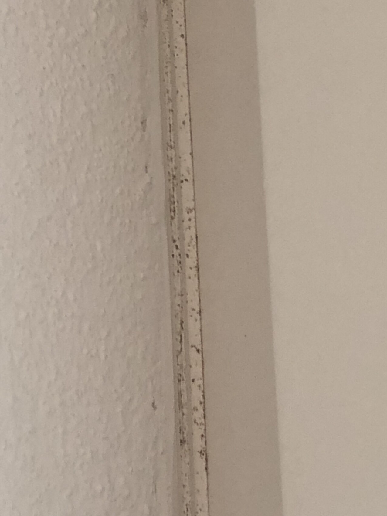

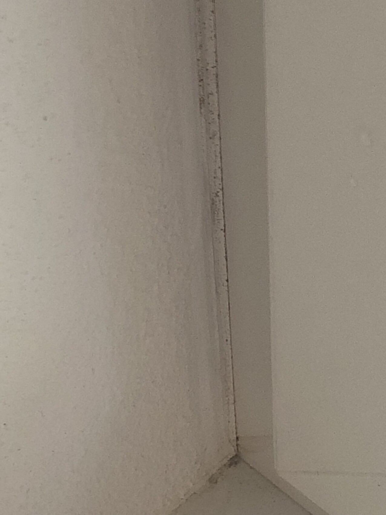

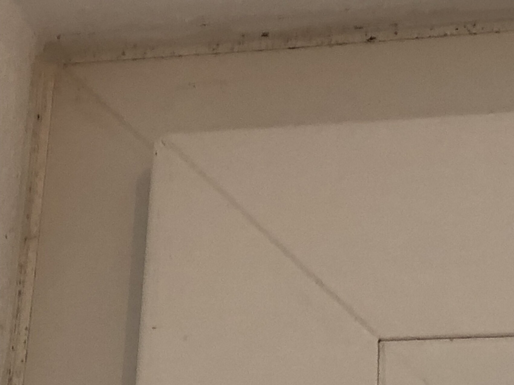

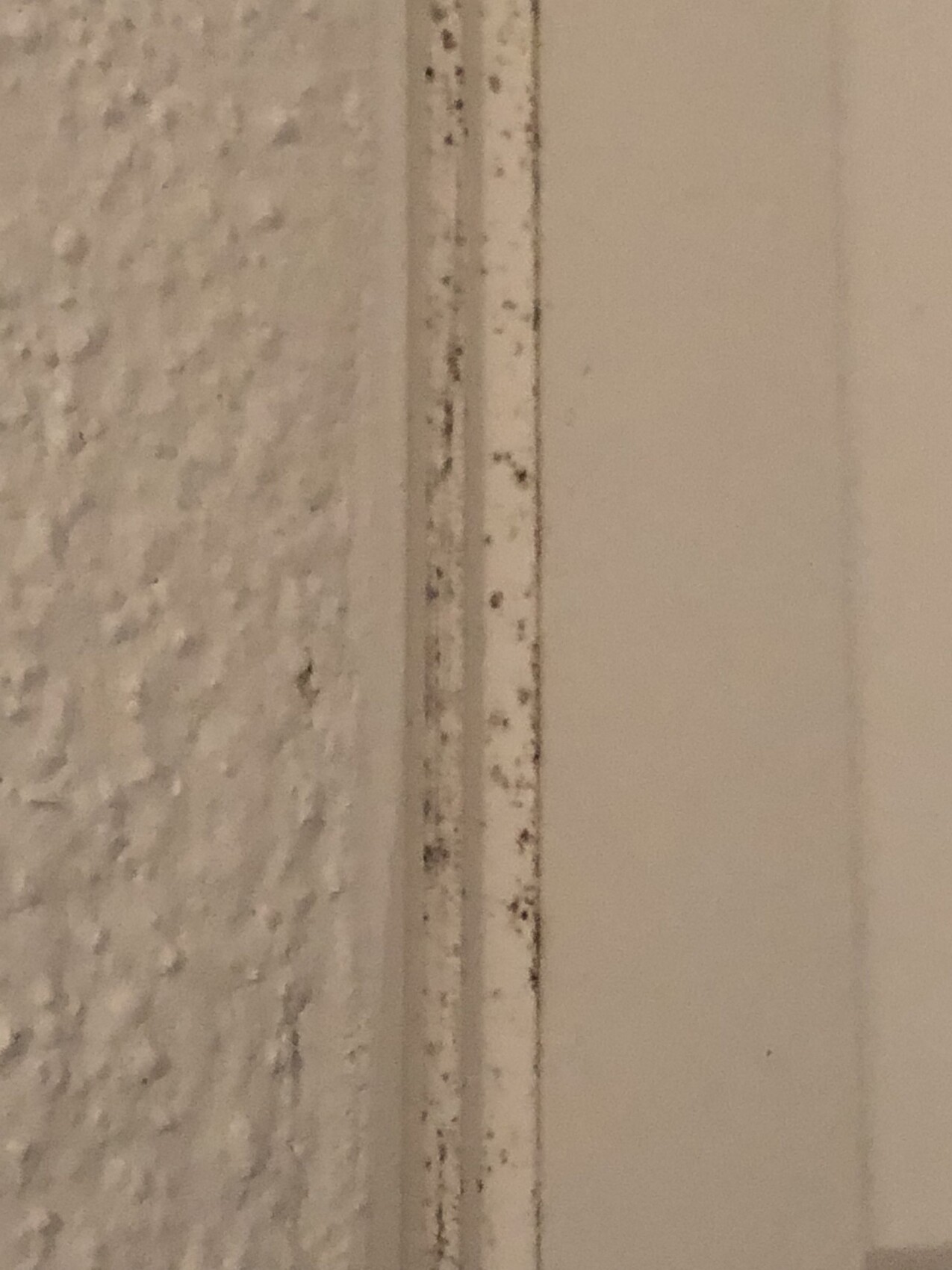

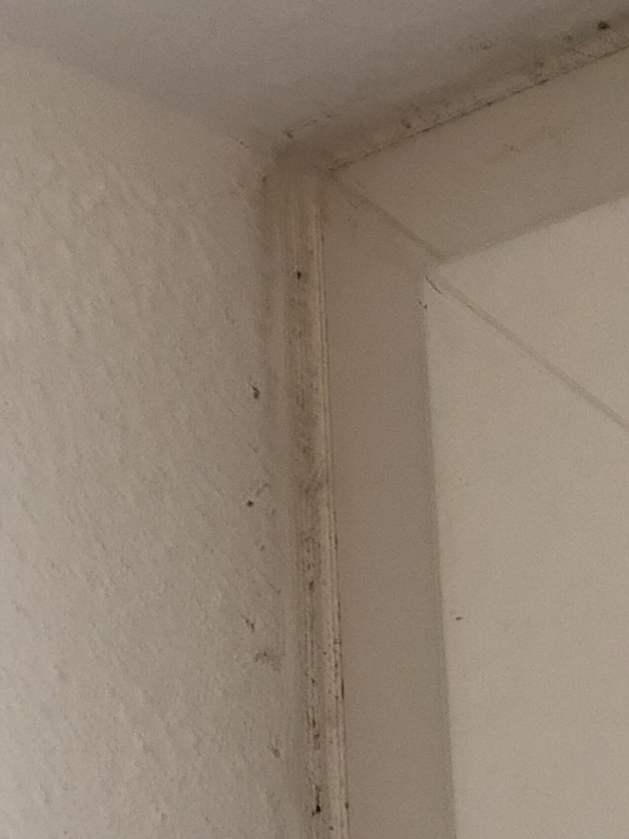

Unfortunately, the pictures are quite blurry, but I hope that some of the experts here can still help identify what this might be.

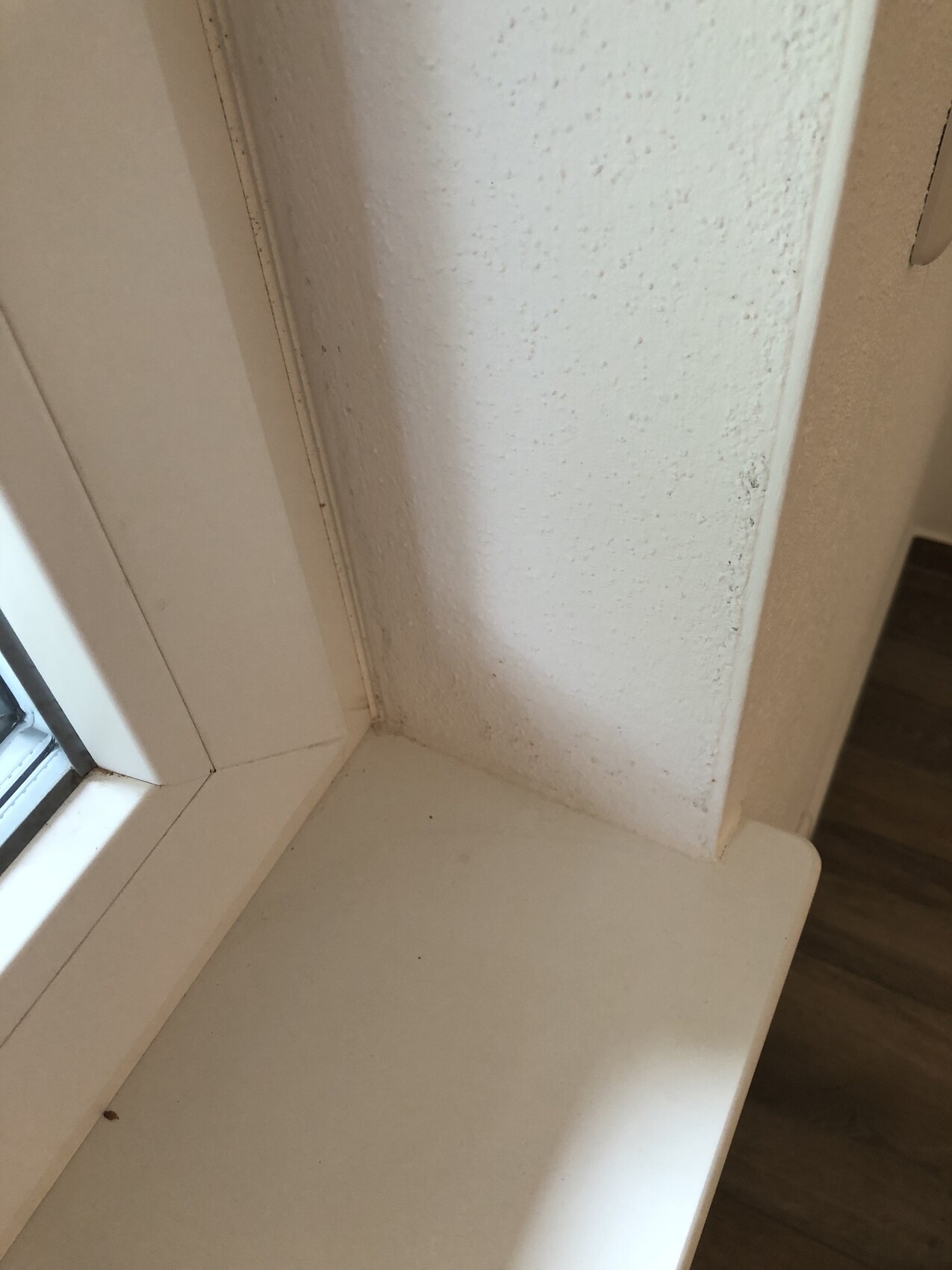

I have uploaded another picture; could the masonry shown also be affected?

The textured wallpaper also has spores. You can permanently remove them using a bleach solution mixed 1 to 5 with water. However, the window sill probably won’t be cured that way; it needs to be removed and replaced. Then you should answer the question of where it is coming from to prevent it from happening again. Okay.

The paint on the textured wallpaper also has spores. You can permanently remove them with a bleach solution diluted 1 to 5 with water. But not from the sill—that needs to be removed and replaced. Then you should address the question of where the moisture is coming from to prevent it from happening again. K.
Thank you, it is plaster without textured wallpaper.
