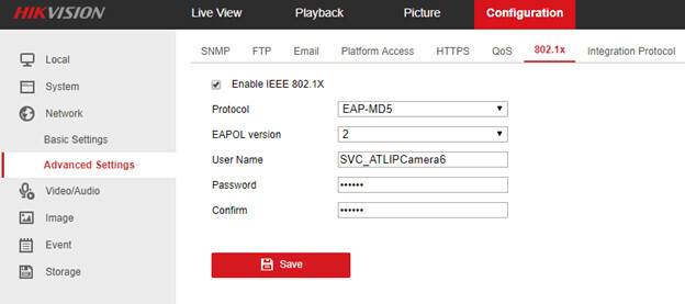

You need something to run the RADIUS server on. For example, I use a pfSense. Then the authorized device must, of course, support 802.1x and know the RADIUS credentials. These devices have a menu option somewhere where you can activate this and enter the login details.
You can’t just plug in any device – or rather, what is the practical goal here? At some point, you must register the allowed device with the system, either through simple MAC filtering or via RADIUS credentials. How do you come to mention a TV now? I thought you wanted to secure outdoor ports? You rarely connect a TV or PC to the RJ45 socket on an outdoor access point under a terrace overhang. In a house (and I assume you mean a private house), you typically don’t have suspicious guests tampering with the LAN. “Vulnerable” ports in a guest room could also be placed in a separate VLAN that is highly restricted.
With Hikvision cameras, it looks like this, for example:
