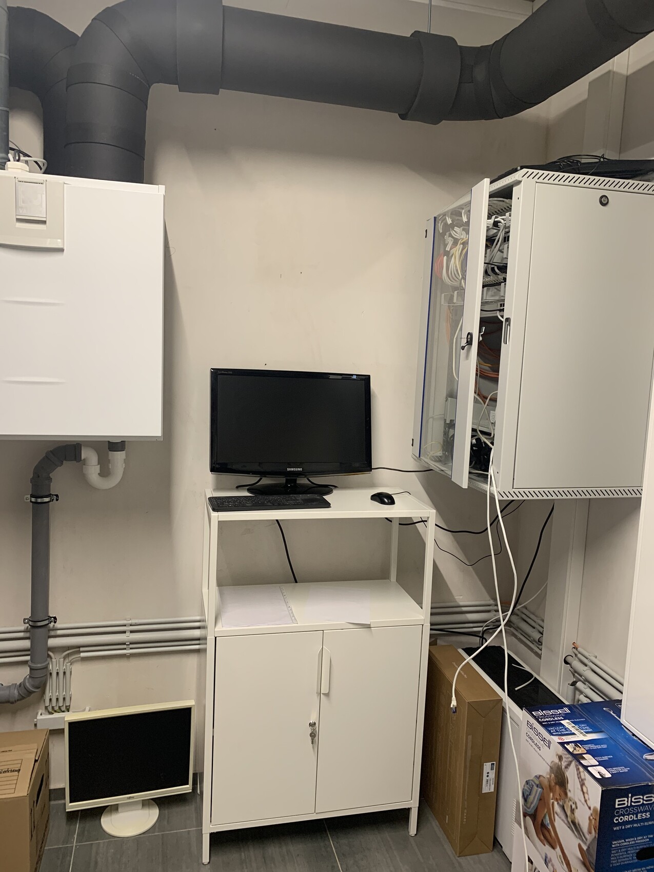

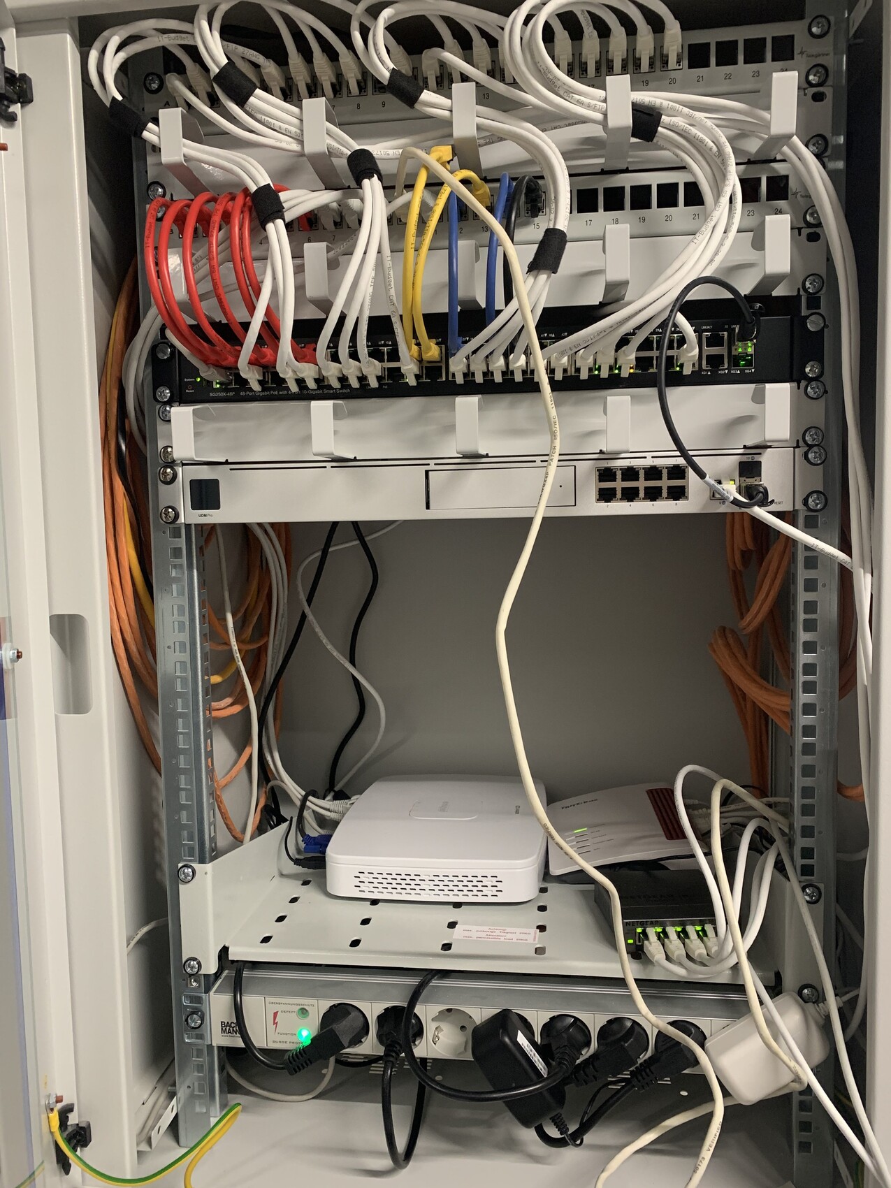

Tarnari1 Nov 2021 23:18
Here is an update…
The UDMPro arrived on Friday and was installed over the long weekend.
OK, it doesn’t look great yet, but it’s coming:
Open network cabinet with cable bundles, switch, and router.
Additionally, a small work desk has found its place. This makes it a bit more comfortable for the few times a year when you need direct access and remote access is not enough.
Small technical room with monitor, cabinet, server rack, cables, and ventilation pipes.
The Magenta receivers together with the GigaSet Go box and the fax run on an old basic Netgear switch connected to the Fritzbox.
The UDM is connected via its WAN port to the Fritzbox, then behind it is the Cisco switch with 10 Gbit, and behind that is the rest of the network.
The NAT on the UDM was disabled. A script runs as a cron job every 15 minutes to check if NAT is still turned off and disables it again if a restart or firewall change re-enables it. A static route on the Fritzbox points traffic from outside into the UDM network.
Conclusion: everything works beautifully.
