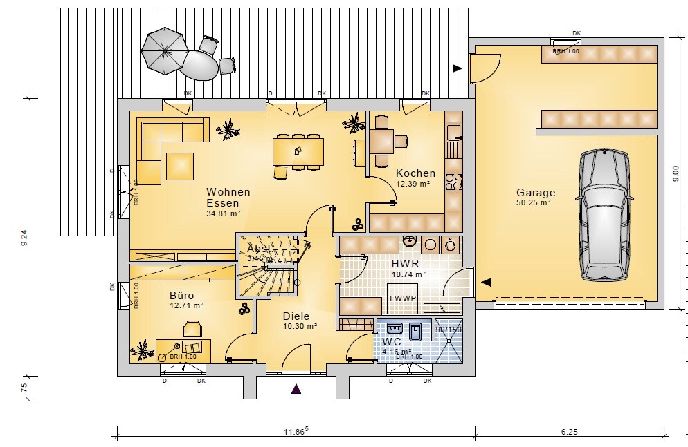

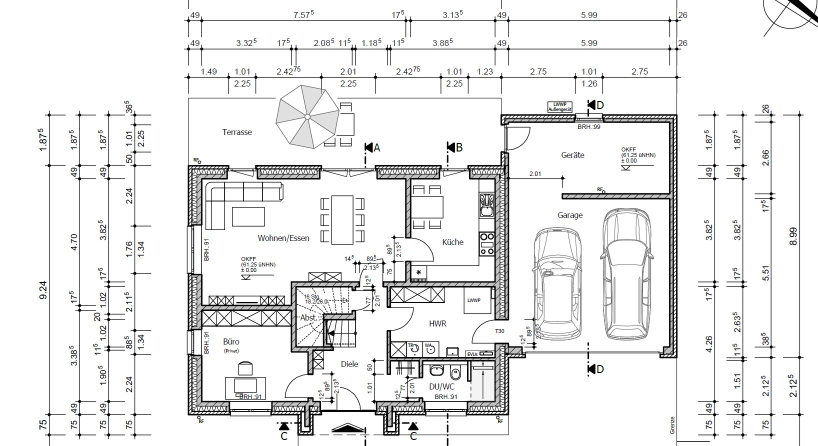

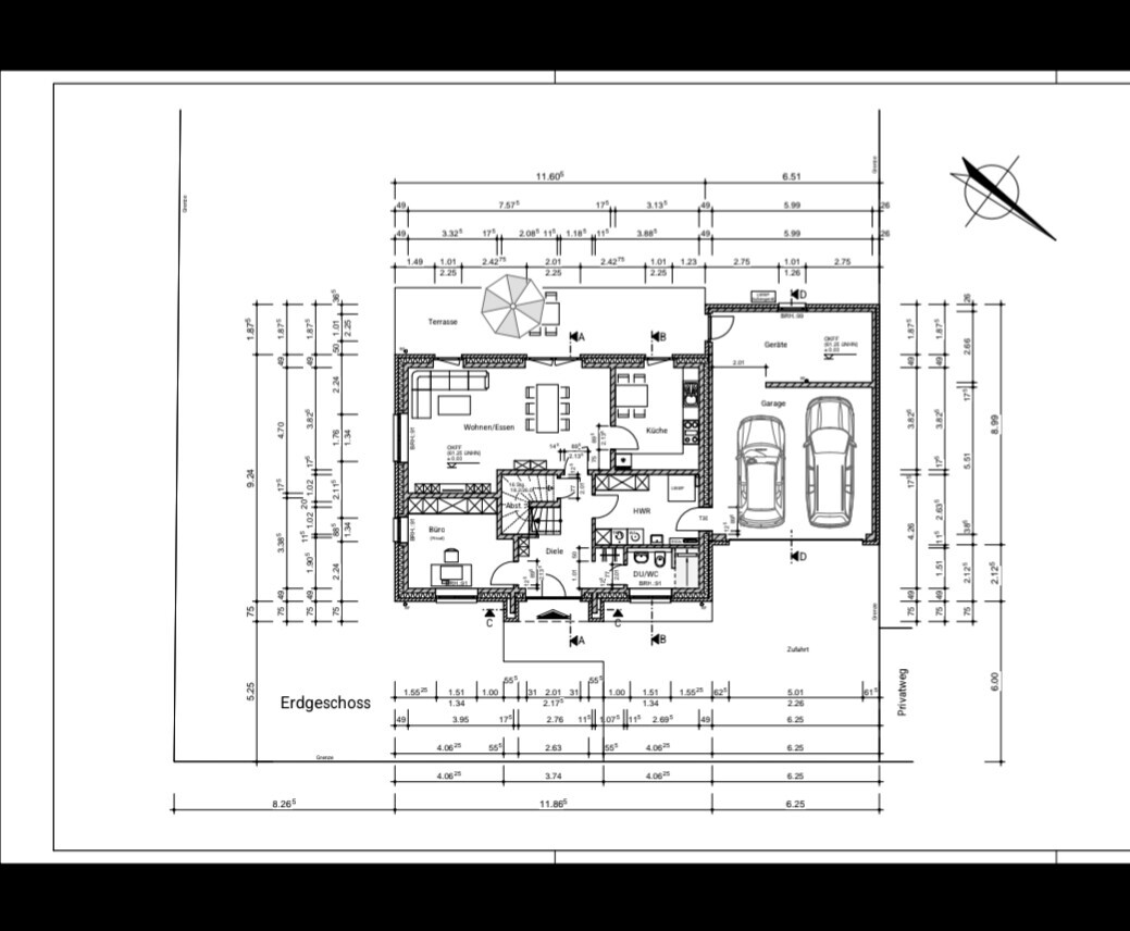

Hi everyone,
Unfortunately, I thought I was smarter than everyone else here in the forum (I have been a quiet reader for a while) and believed I could rely on the general contractor’s planning. Now, right from the start, things are becoming "interesting." I’m not sure whether my frustration is justified or if this is just standard practice in the construction industry. Here’s the situation:
Based on the preliminary design from the general contractor, we awarded the contract (signed the agreement) with the expectation that the room sizes would match the preliminary design. The house is planned as a KfW 40 energy-efficient building with sand-lime brick, insulation, and brick veneer. This was included in the offer along with additional requests, and the design was adjusted accordingly, if necessary. So, it’s not like the general contractor was unaware of our KfW 40 project. Now we have received the building permit drawings showing roughly 8 m² (86 sq ft) less living space due to suddenly thicker walls, both external and internal. The exterior walls were increased from 42.5 cm (17 inches) to 49 cm (19 inches) thickness. And this was done inward, not outward. In other words, each side has lost 6.5 cm (2.5 inches) of interior living space. Calculated in euros, that’s about €22,000 less living area based on the price per square meter. Or, in other words: the general contractor now has to buy fewer sand-lime bricks and build with less material, with less plastering, tiling, screed, underfloor heating, pipes, etc. However, there was no price reduction.
Is this common practice? Should one accept something like this?
Additionally, the attic floor has lost 13 cm (5 inches) in width and 6.5 cm (2.5 inches) of interior height due to the knee wall being shifted further inward. We had planned to convert this space later, which now seems hardly worthwhile. The general contractor knew about this in advance and even planned wiring and such in the attic/roof space.
How do you assess this situation, and how would you proceed?

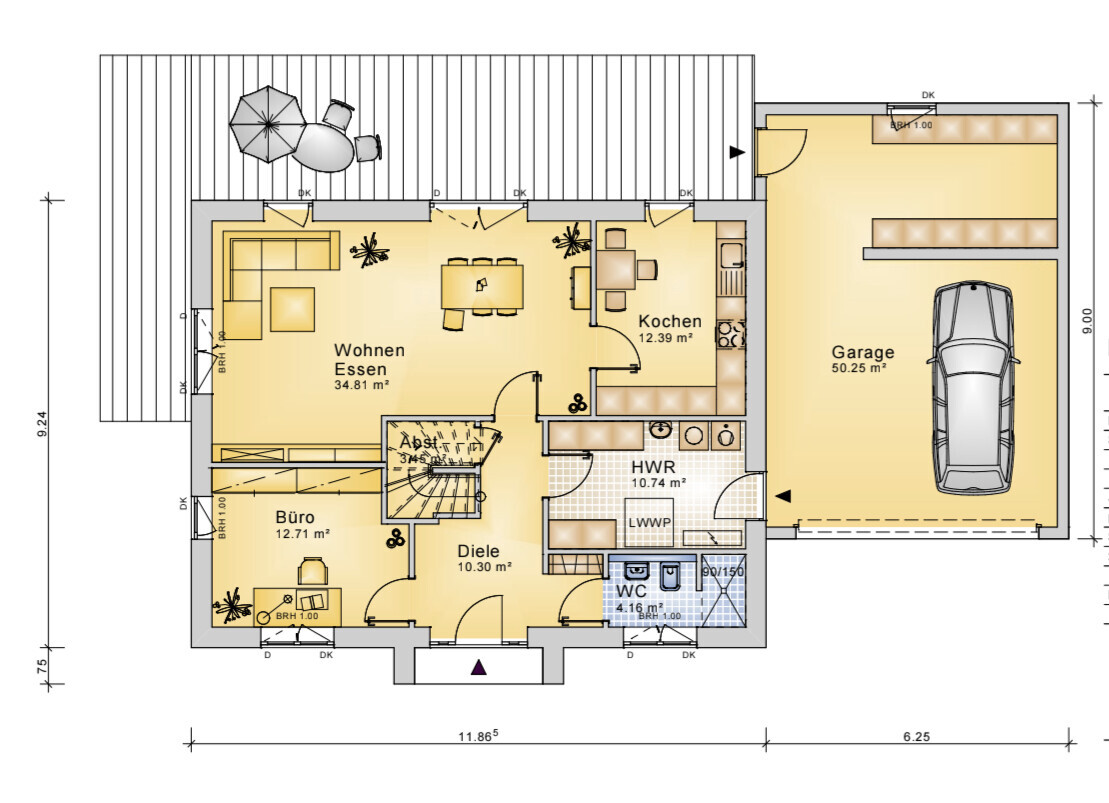

By preliminary design, I mean the draft typically created with a GC before signing anything. For example, it didn’t contain exact room dimensions, only what is shown here. I have simply uploaded the draft and the drawing for the building permit. Maybe it will become clearer what I mean. I should also mention that this is not a catalog floor plan in this case, as we pre-drew everything ourselves (only with desired room sizes, without exact measurements) and sent it to the GC, who then professionally drew up the design.
