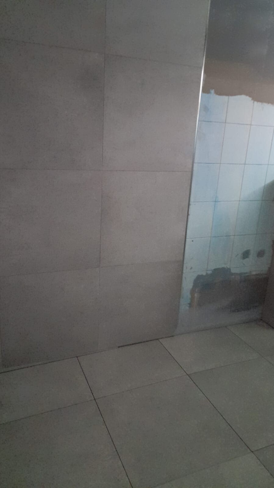

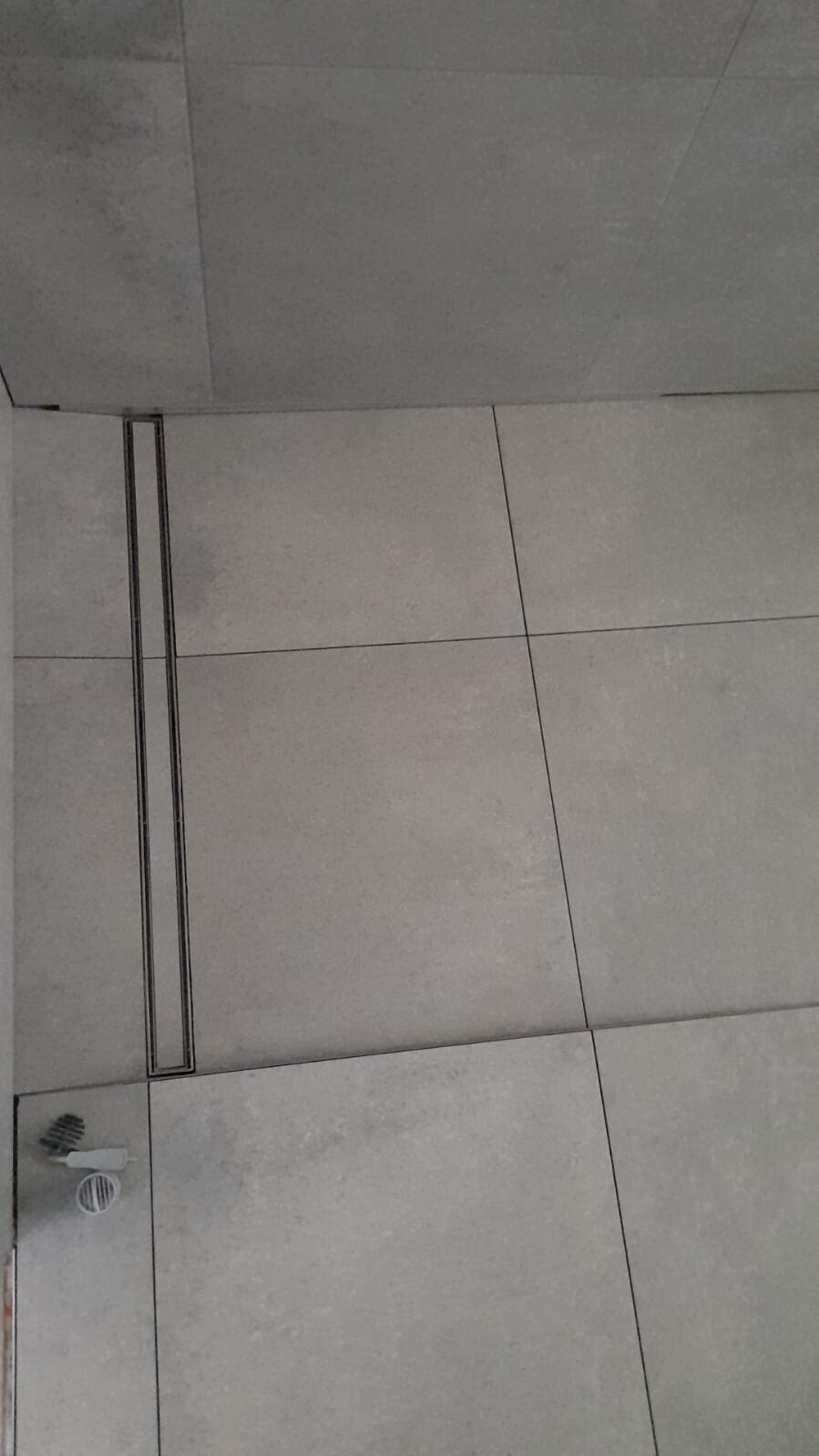

We were completely shocked when we entered our newly tiled bathroom. The tiler installed the wall tiles and grout lines in the shower unevenly in relation to the floor tiles. The problem is: we never received a tile layout plan beforehand, nor did he ask us how we wanted it done. Now we are very disappointed and absolutely don’t like how it looks! Is our only option to have the tiles removed, have it redone, and pay twice as much?

Is there a photo of it so we don't have to imagine it entirely?

Here are two pictures from different perspectives...
Large gray bathroom tiles on wall next to mirror with blue accents
Gray tiled floor with long rectangular floor drain in a bathroom.

Well, a bathroom layout showing the planned tile arrangement and installations (bathtub, etc.) with measurements would also be helpful. It seems the floor tiles are continuous throughout.
