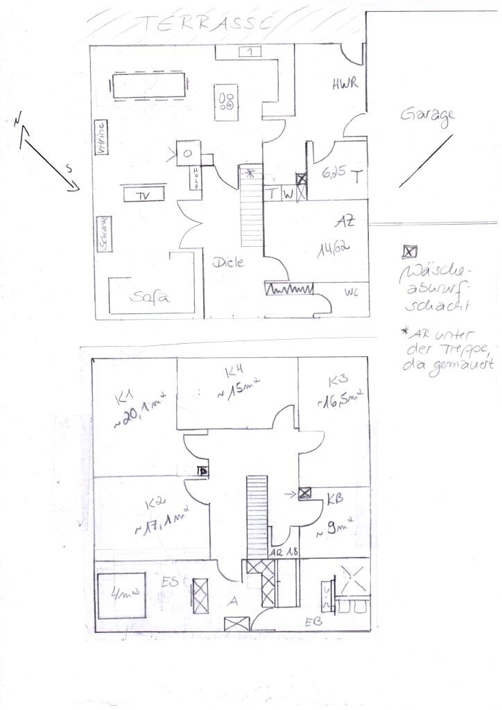

we are planning to build for the second time and have spent a lot of time working on the floor plan—revising and adjusting it. Now it’s finished, or at least we think so. What do you think?
Basic details: city villa, 250m2 (2691 sq ft), for 6 people on a 741m2 (7976 sq ft) plot.
We’re curious to hear your thoughts.

The challenge for a layperson is that at some point, they assume this is final and do not consider starting over. Here, the living room just came together naturally, and upstairs the rooms are simply lined up. The bedroom is a walkthrough room; it might be worth considering a laundry area on the upper floor, as is often recommended elsewhere.
The orientation of the house is questionable. Regarding the issue of overbuilding: there are always options, since not every paving stone contributes to impervious coverage. An architect can provide better advice and address any concerns.
Edit: The utility room is difficult to furnish, and now there is the unplanned chute, which will need a place somewhere.

Right now, we have an open living and dining area, but we no longer want that. We want a separate, cozy living area that can be opened up with double doors. A home office on the ground floor is essential since it will be used daily and we want to avoid going up and down the stairs every day—so it should be as simple and comfortable as possible. The attic is planned to be used as storage and possibly as a playroom; however, the space is not ideal for a children’s bedroom. Storage space is available on the ground floor under the masonry staircase. On the upper floor, this has been sacrificed in favor of larger children’s bedrooms. Of course, I could explain everything individually, but that would probably be too much here.
We are very grateful for suggestions, criticism, and ideas. If something can be implemented, we will try to do it—that’s why we are here.
However, everything must remain affordable for us. Anything is possible—with the right budget, a house can be made significantly larger, and then we wouldn’t have to try so hard to fit everything necessary into the space.
Here, we have tried to develop a functional floor plan for us and to correct or avoid mistakes from our current house.
Unfortunately, the shaft in the dressing room does not fit; it would end up in the kitchen :-(
The terrace extends along the entire living, dining, and kitchen side, as well as a small one near the home office and living room window.

although we are not architects, we gave it another try and started over from scratch based on the suggestions and honest feedback on the first version. The result looks like this:
Sketch of a two-story house with terrace, garage, kitchen, living room, and bedrooms.
lastdrop13 Jan 2015 09:21
Do it again with the actual wall thickness and dimensions.
Then you will see that it doesn't work this way, sorry.
