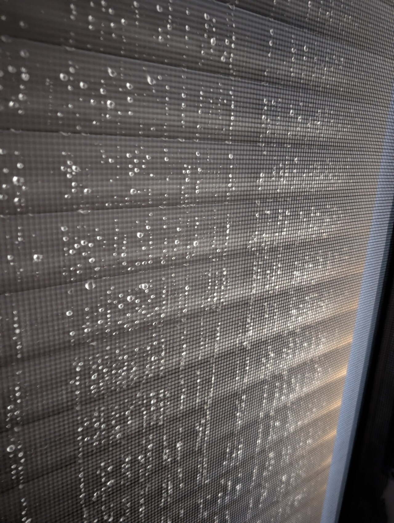

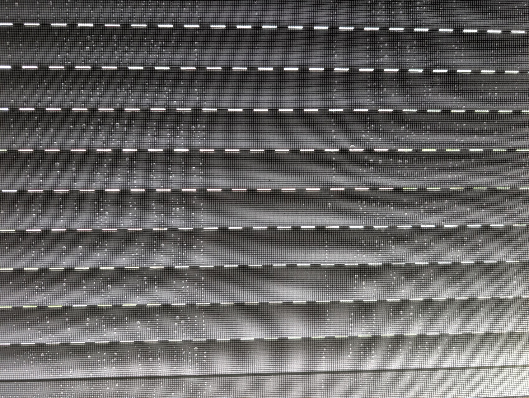

In my condominium, new windows have been installed, and one of the windows also has an external roller shutter. When it rains, water runs down the inside of the roller shutters, both when they are fully closed and when they are partially closed (see photos).
The company that installed the roller shutters says this is normal. Is that true? I find it a bit odd and am concerned that when the shutters are raised, the moisture might get into the roller shutter box, potentially damaging the shutters relatively quickly.

11ant26 Jun 2025 12:34
This is obviously not normal and clearly a defect. Unfortunately, it is not possible to identify the cause since you have not shown the situation from the outside as well. In the pictures, I only see an insect screen wet with raindrops behind a blind, but nothing of the blind’s construction or its housing is visible.

Mahri2327 Jun 2025 09:13
there shouldn’t be that many water droplets on the inside of your insect screen. At least, that’s not the case here.
So I would also say that this is a defect.
Musketier27 Jun 2025 09:21
If it becomes this wet during rain with the shutters closed, you need to be able to observe where all the water is coming from.
If it is an exterior roller shutter box, the water can only be running behind it. At least, the even streaks of raindrops on the insect screen suggest this.

As 11ant already told you, you should post photos of the problem itself, not just the effects.
