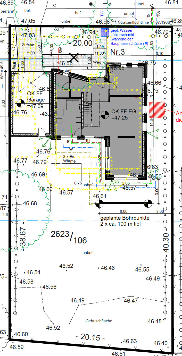

For the water connection, we submitted an application for modification with the Berlin Waterworks (BWB), as we planned together with our architect to relocate the water chamber centrally to the property boundary. A corresponding site plan was submitted.

- Does this mean that we are allowed to reroute the pipe from the demolition building ourselves and only the connection point is handled by BWB?
- Do we now have to construct the new water meter chamber at the existing pipe location, even if this location is rather inconvenient for our new construction?

Sonar87 schrieb:
Although we have an architect, this issue unfortunately slipped through, However, your questions should be fully answered by them. Ultimately, these are also local conditions that depend on how things are handled in your area.
Sonar87 schrieb:
that the connection was completely redone Connections are always completely redone. Everything is treated like new construction (which it actually is).
