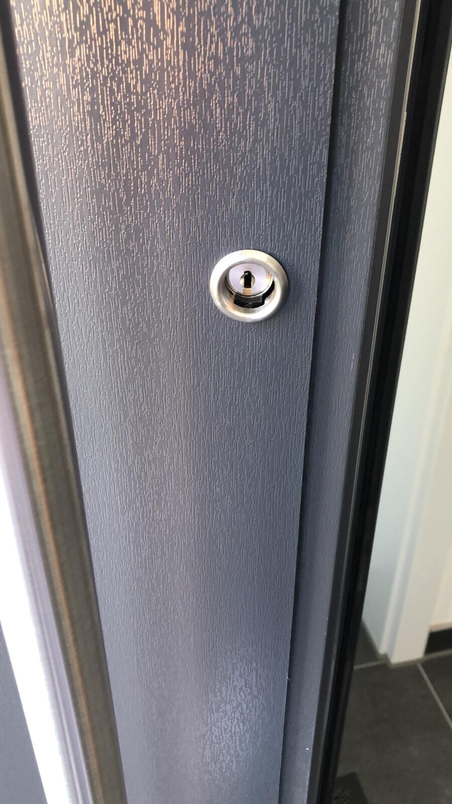

Today our front door was installed.
I noticed that the lock cylinder is set quite far INSIDE the door.
Is this correct? Or did the door installer fit a lock that is too short?
Close-up of a round lock cylinder on a blue painted door.

Could it be that the safety rosette is missing?
Sabine
guckuck2
15 Apr 2020 15:49
Yes, ask your supplier if they might have made a measurement error with the cylinder.
Mycraft15 Apr 2020 15:49
It could be either... either too short a cylinder or missing drill protection.
Bookstar
15 Apr 2020 16:13
this is definitely not a nice rosette
seat8815 Apr 2020 19:10
There is definitely something wrong. You can actually look inside from below.... Maybe it was installed upside down? What does it look like on the inside?
