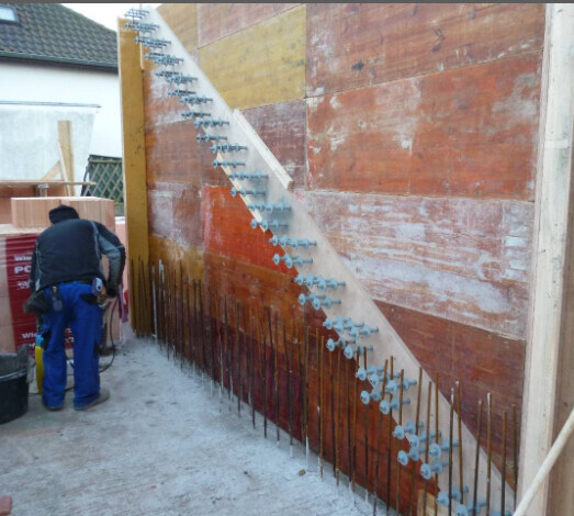

Normally, the anchors are cast into the concrete.
Construction site: inclined metal staircase attached to wooden wall, steel reinforcement protruding from the floor, workers at work.
